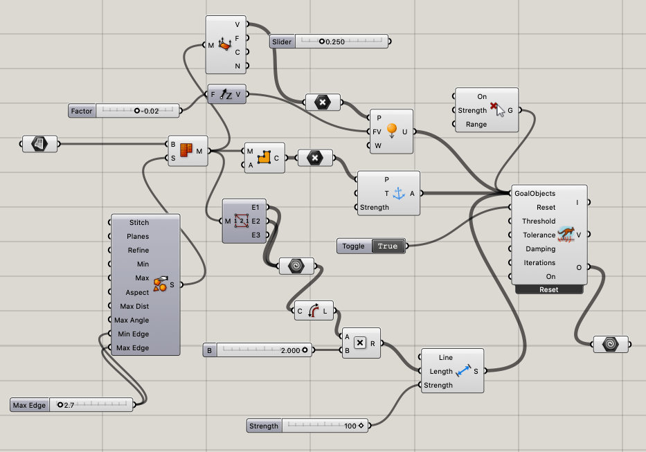

almost 6 years ago by t inglis
Thought I followed the directions, but the results aren't matching at all. Thanks in advance for any help!
Hi Inglis,
You have nothing plugged into the Line input from the Spring component. And I would flatten the GoalObjects input from the Kangaroo component just to be safe.
One reason the points are sinking is that the corner points are both Anchor points and have a downward force of -0.2. In other words, they're being used double. You could increase the strength of the anchor component or filter the corner points out of the list you plug into the Load component.
