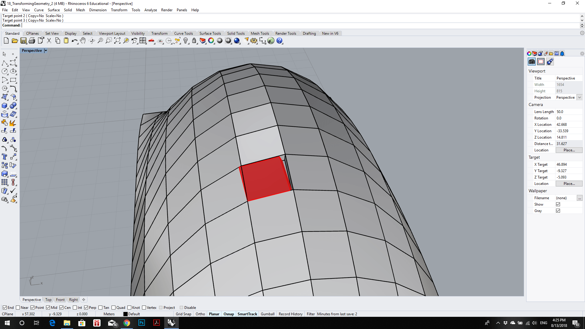

Whenever I select the Orient3pt command on the red box, it isn't fitting into the hole properly. Attached is an image of the result. Might this have anything to do with the most recent version of rhino?

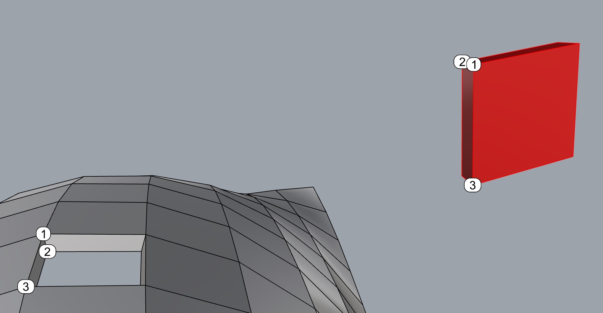

Hi Eytan,
It is a little tricky to get the reference points right, if you select them in the wrong order the geometry will orientate in the wrong way.
Attached is an image of how to select the 3 reference points and in which order.
Let me know if you were able to make it work
