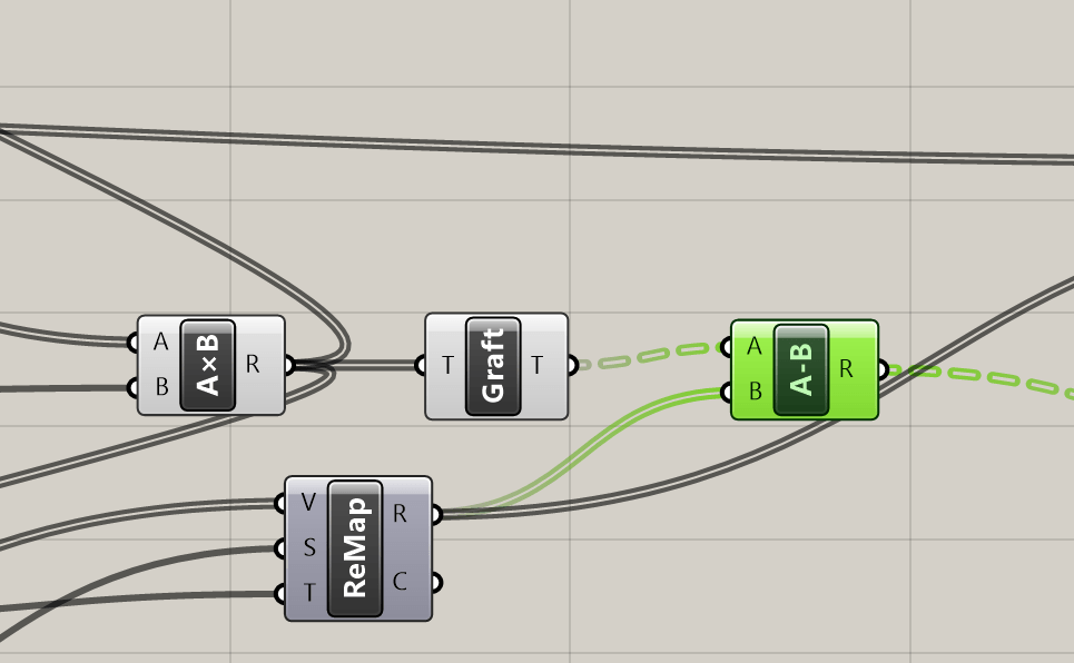

when you are subtracting the two value ,can you please tell me how the grasshopper is subtracting the values?

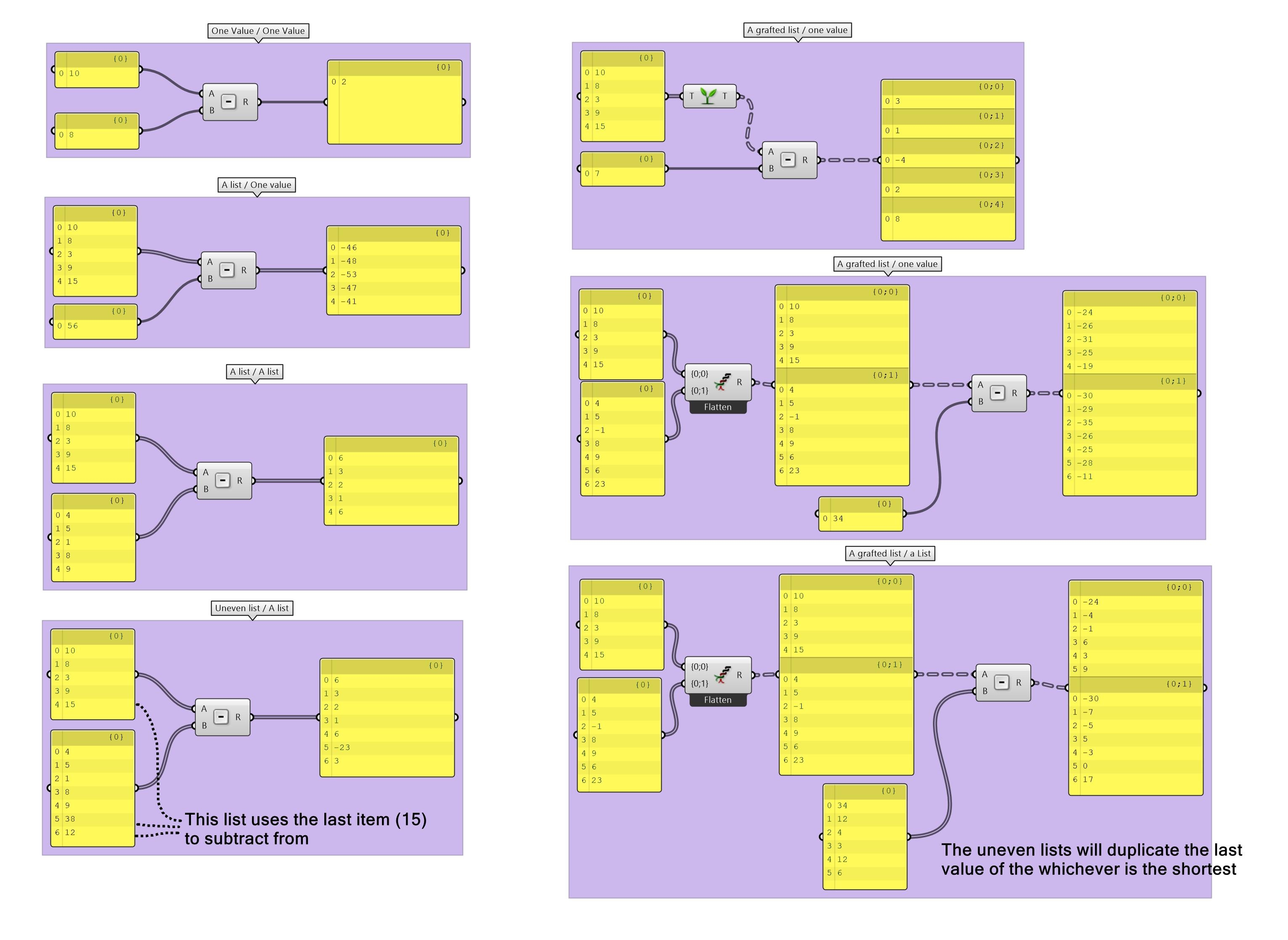

But there are various cases:
I'm attaching an image with all these examples so you can check what happens in every case.
