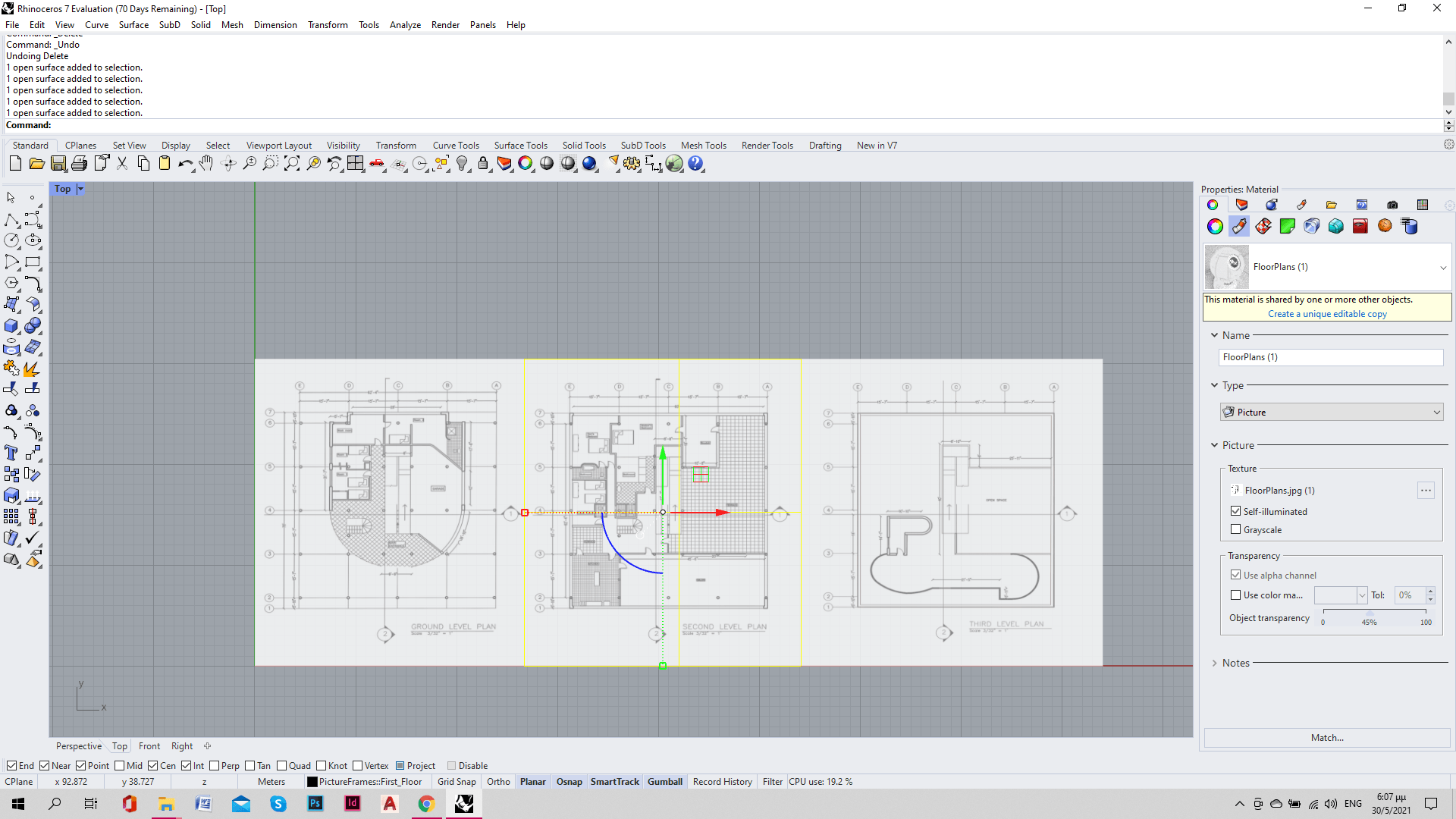

Hello, After spliting the image to three floorplans and putting them in the right layers, I tried to change the transparency of the one selected, as shown in the video, but insteaf of affecting only the chisen one all three were affected. Is there a reason this might happen and how can I fix it? Thank you in advance
Hi Martha,
A bit late, but it's because the same texture (the image) is applied to all of the surfaces. You're right. What you can do is just copy the material and apply it separately to the surfaces.
