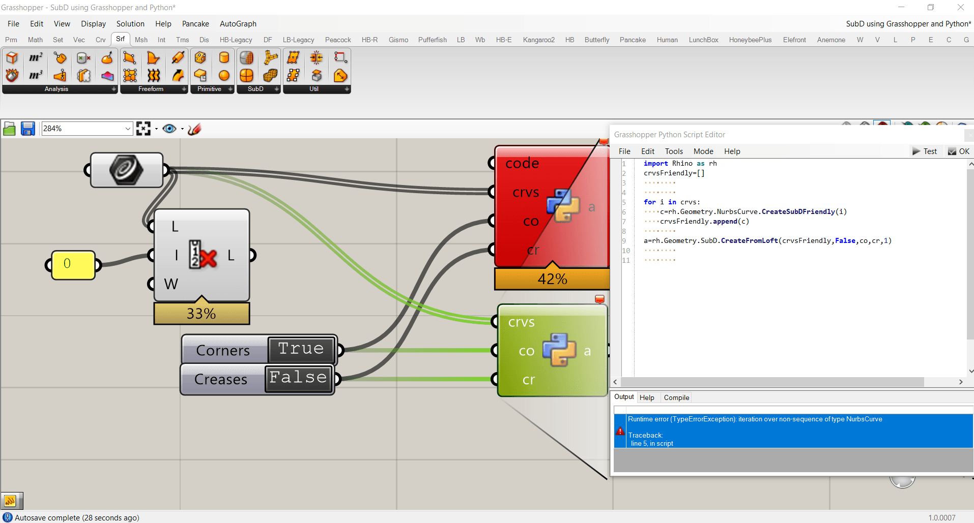

Hey guys, I`m stuck on the code fragment. Not sure what can be wrong since I have triple checked everything... :( Help a n00b...
Carlos Jacquet about 3 years ago
Now I got it. I had forgotten to right click over the component over "Crvs" and set it as list =P
