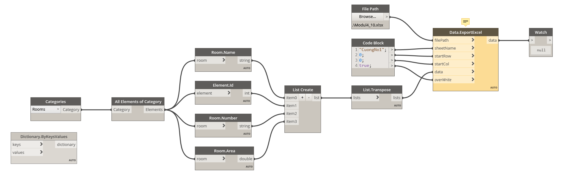

I got this: Warning: Data.ExportExcel operation failed. I'v try follow: https://knowledge.autodesk.com/support/revit-products/troubleshooting/caas/sfdcarticles/sfdcarticles/Excel-ReadFromFile-of-Dynamo-doesn-t-work.html But it still not run
Hi,
I think your MS Office and your MS Windows are not the same architecture (32bit vs 64bit).
Causes:Version incompatibility: Microsoft Office OS Version(32Bit) different from Windows OS(64Bit) version
Solution:The bit version of the Microsoft Office OS and the Windows OS should be same.
