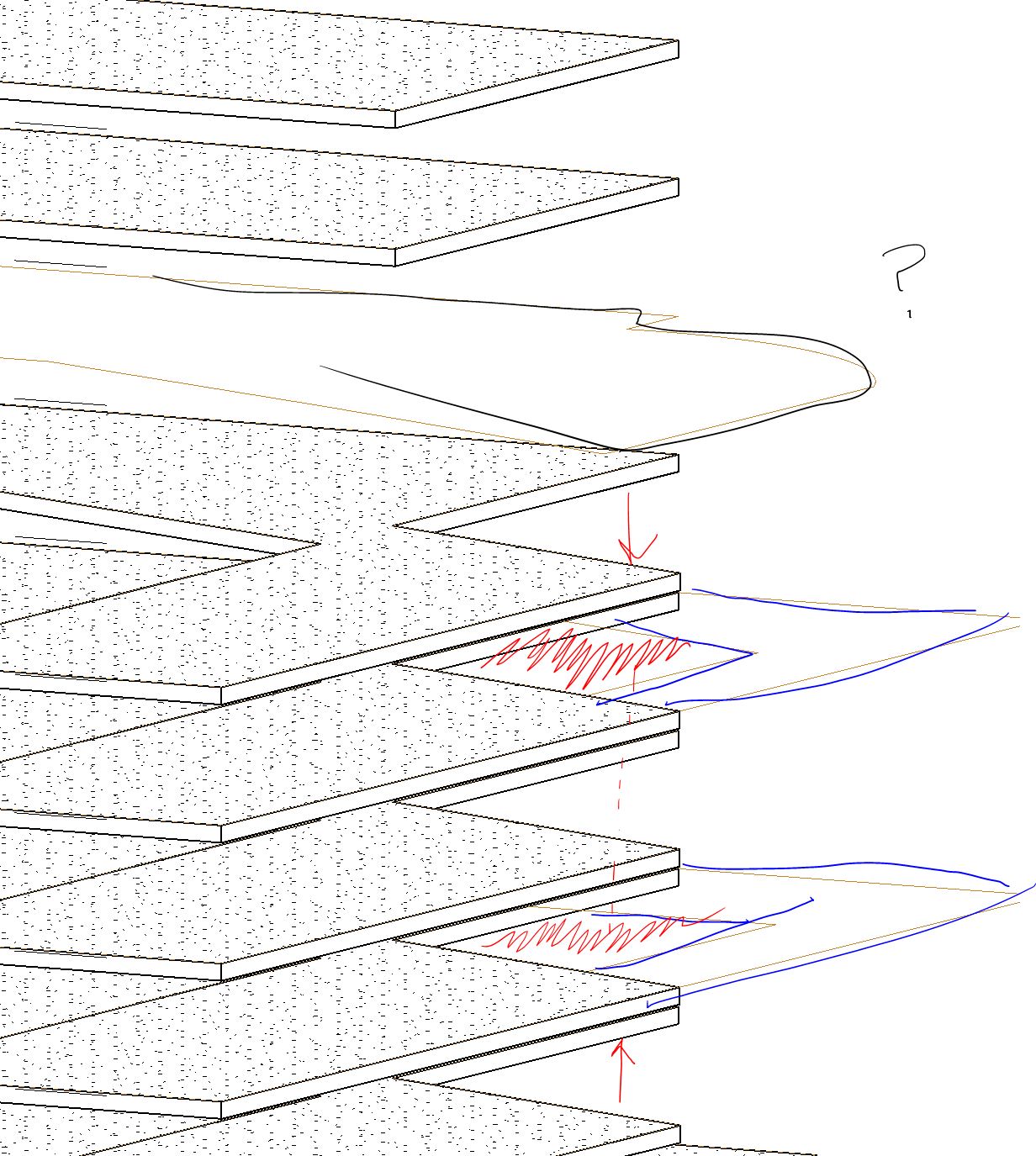

Hi! I'm looking for the solution for two problems: 1) I have two floors with an opening... see red scrible... In the case of the opening I have used to two curves next to each other to create the opening, see the blue line. But seems like GH only picks one curve per level? How do you solve for openings? 2) The black lines shows a curve that doesn't create a floor. I have made sure it's closed and planar. What else can I do?
Hi Andy,
This seems like a Data Tree issue, where GH picks the 'wrong' curves to create the floors.
Could you share your definition? I'll have a look. (use wetransfer or similar)
