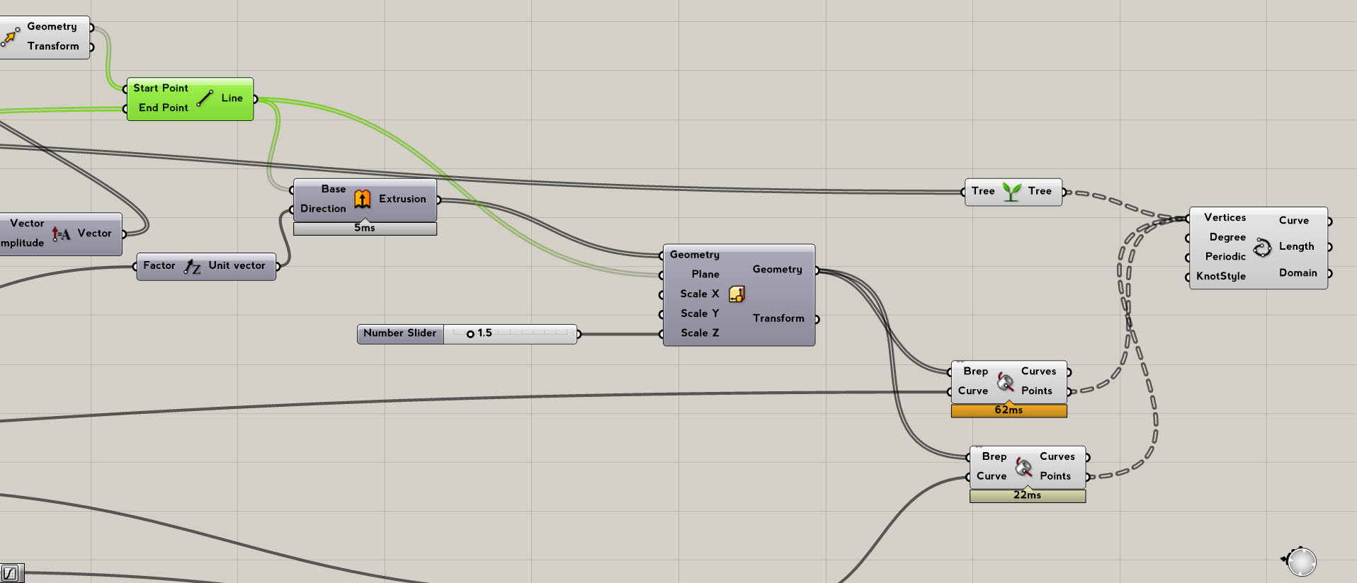

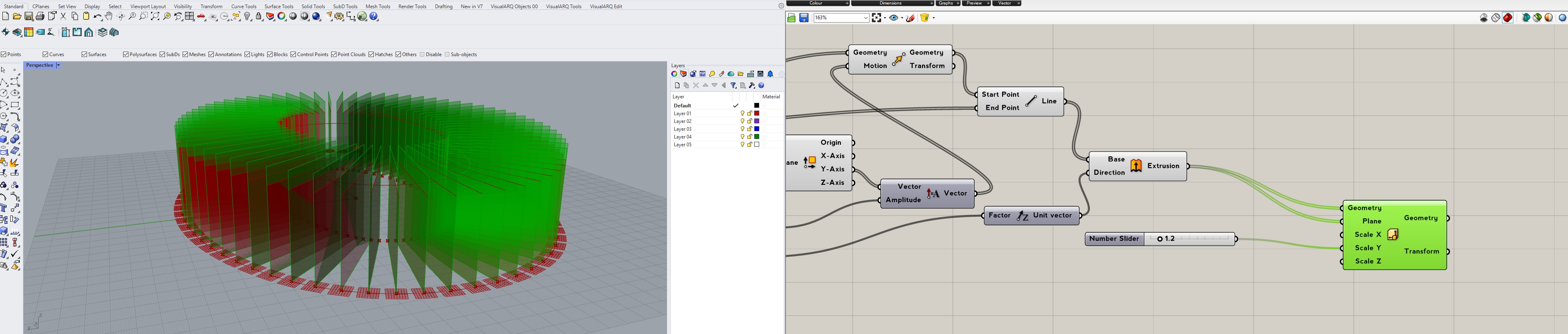

Hi, at 12:28 my Scale NU component scales my planes upwards in the Z-Axis instead of along the Y-Axis (please see attached image)... Can't seem to find a solution to this. I'm using Grasshopper with Rhino 7. Thanks.
Hi Sakhile,Ok nice! Yes, the plane input for the NU component is very important to get correct. It's the basis for the scalig operation to know in which direction the axis are oriented. Best,Arie

Here's a screenshot of it.

I found a solution, more of a work-around. I used the line(s) generated to make the extrusion as the 'Plane' input and scaled along the Z-axis instead.
