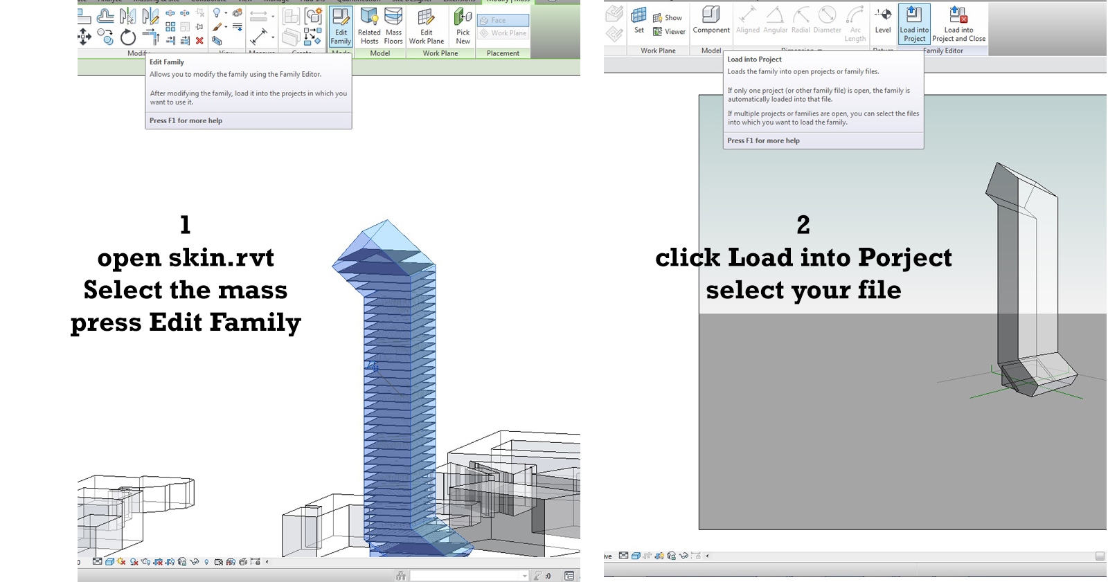

@Omar : Thanks , that works!
@Jesica : Just need to select option3 in the skin.rvt to be able to select the new mass.

What you can do is open the skin.rvt file from the included assets. Select on the mass, click on "edit family", then click on "load into project", after which you can load the Form mass into you revit file.

if i select the select the mass, i don't have the comand edit family....is it normal?
