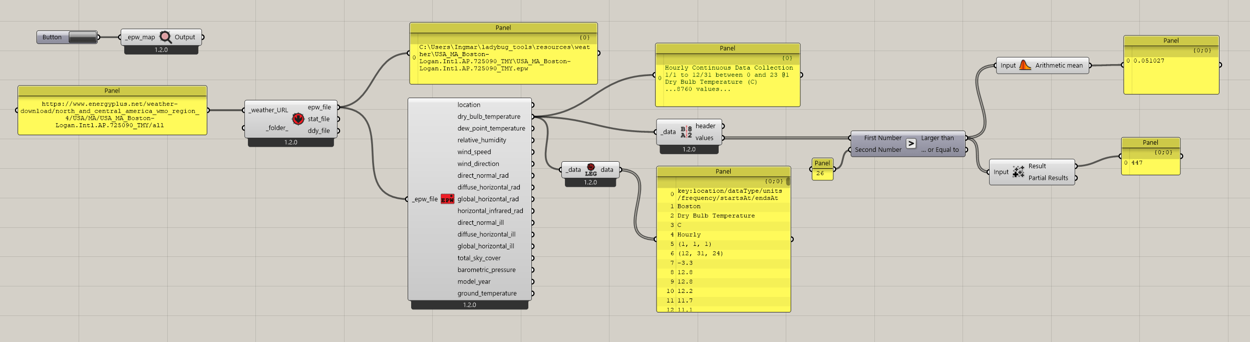

almost 5 years ago by Ingmar Christoff Büchner
I have attached an image that contains the updated solution to be able to follow this tutorial. There are a few differences, but the most important difference here, is that you need to use the "LB Data To Legacy (ToLegacy)" node to be able to filter the data.
