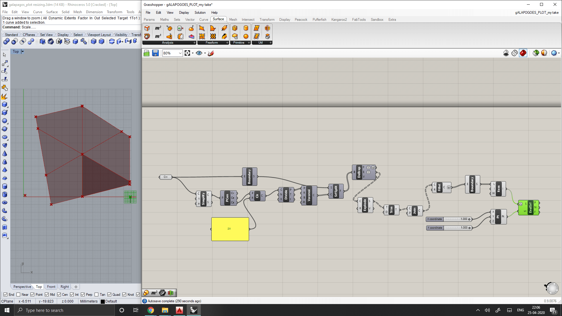

Hi Arie , In this example , there is a 5 edge polygon divided into 5 parts .. incase we increase the divisions to 6 , then shattering of lines at the mid segment will not yield the answer. While i tried a different flow , i have been unable to parameterize the individual 6 faces , it keeps on evaluating the parent (larger) surface , and that also the bounding box ... not the surface . I have attached an image to explain it . Thanks , Devyani

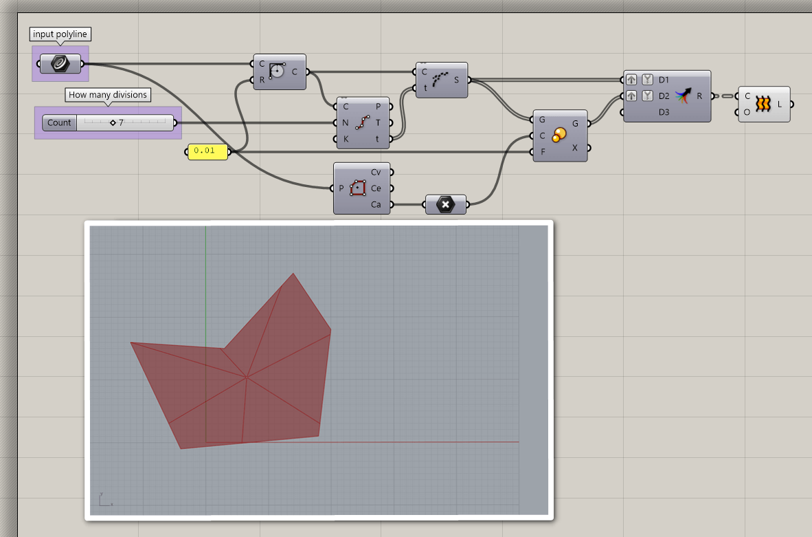

Hi Devyani,
See the attached image, which should let you divide a polyline boundary in whatever number of segments you prefer.
