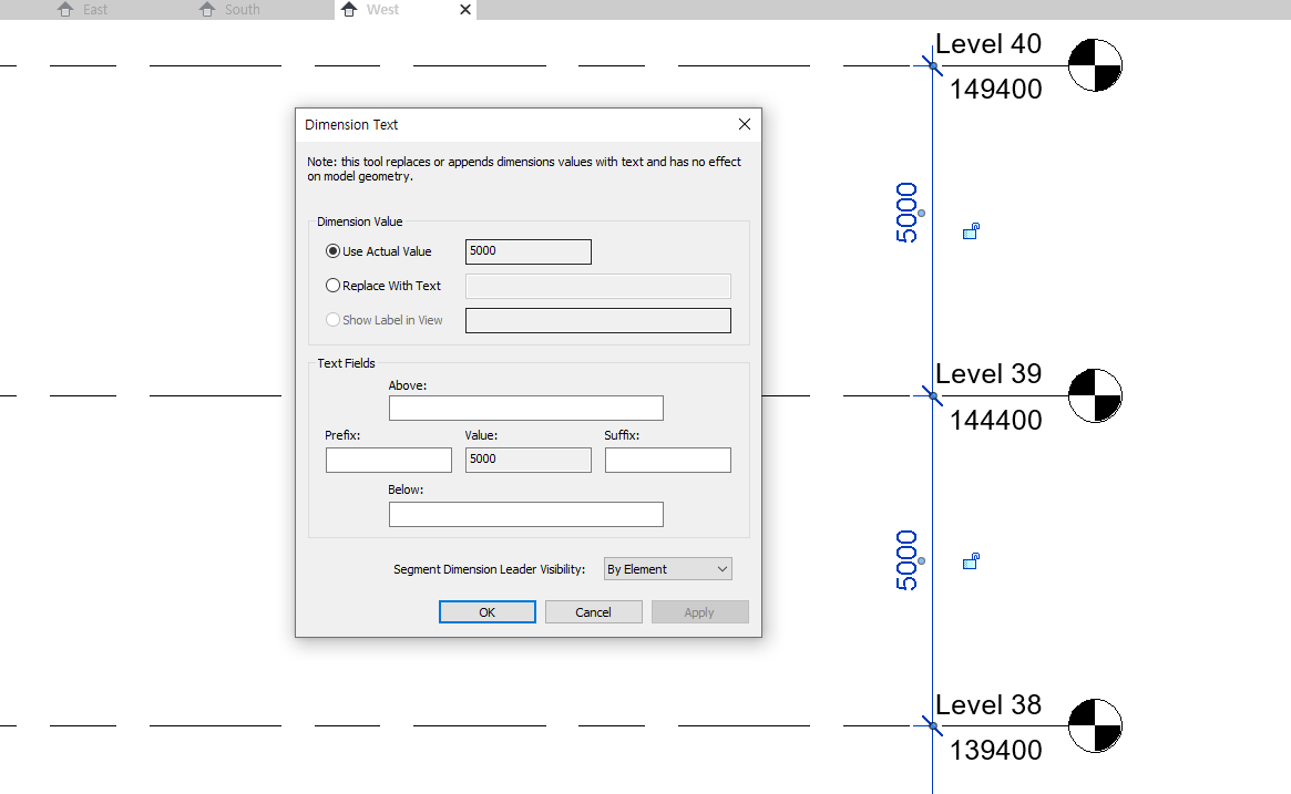

When I try to change the height by changing the dimension, a window is popped up and I cannot change the number. Sometimes I can enter the number but sometimes I cannot. I can change the height if I move the line but I want to know why I could not change the dimension. What is the problem?

Try clicking on the Level Line and/ or double-clicking the Number underneath the Level (139400) and type in what you want.

I believe this Dimension Text Editor just changes the text being displayed and does not change any geometry (your height). So if you want to change the height you have to model it.
