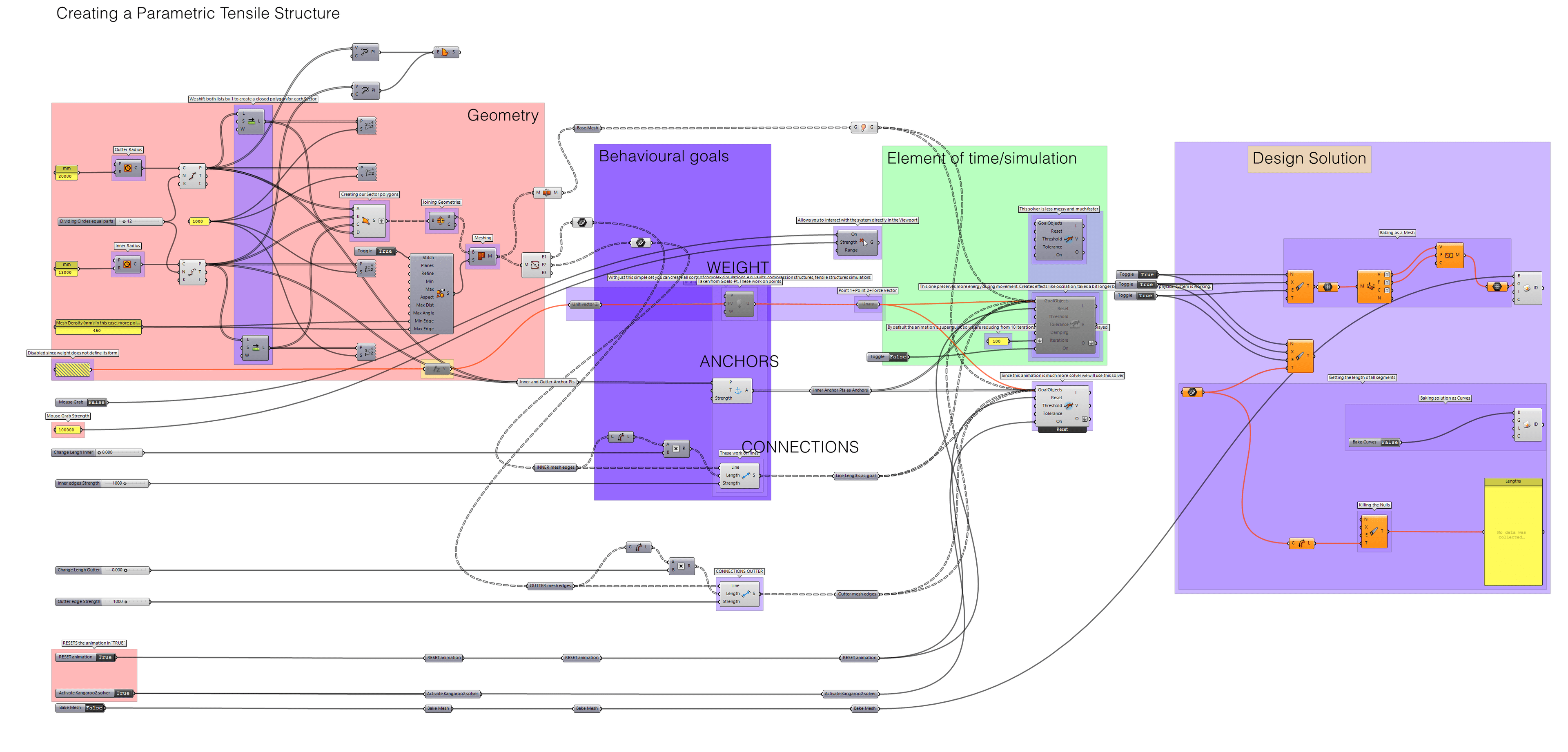

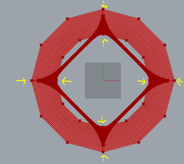

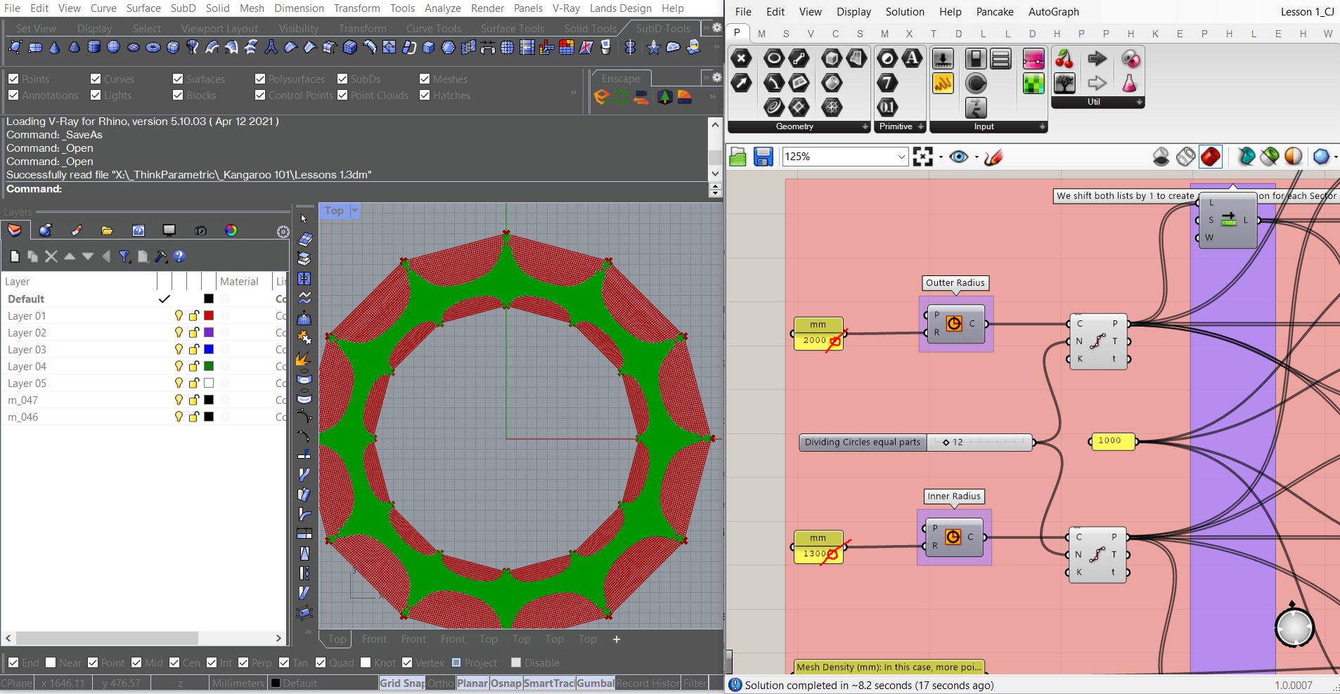

Hey Jaime! I know this course is not the most recent, but still, I am somehow stuck at 7 minutes of this lesson. Every other lesson worked just fine, but now when I start the First simulation of the parametric "tensile mesh", it will only recognize 8 anchor points (4 of the outer ring and 4 of the inner ring). I have tried rebuilding it many times but could not spot my mistake. Would be glad if you could give me a small help on this one! Thanks in advance! And some screenshots will follow!

In the end, the problem seemed to be the scale...
I'm beginning to suspect that Grasshopper does not enjoy working in mm or with numbers with a large amounts of digits.
By reducing the size of the strucre by a factor of 10 it recognized all the points!
So that was it f.y.i.
