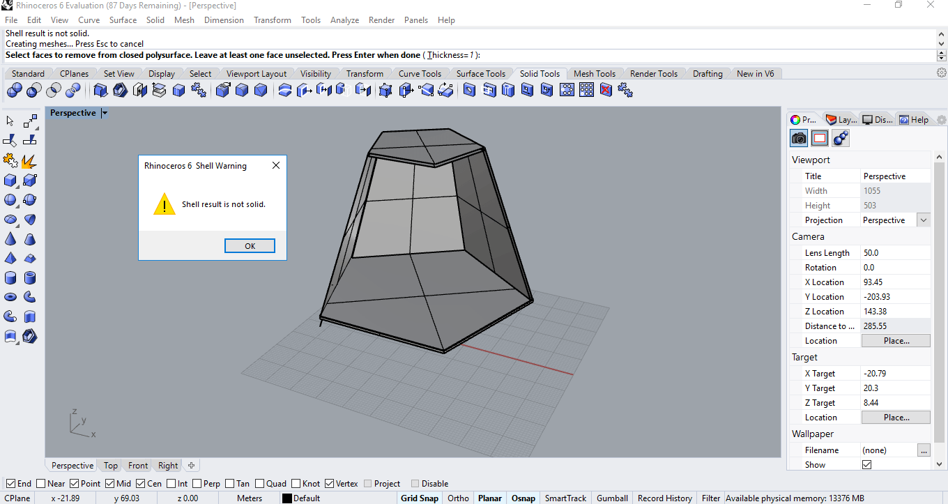

I used the shell command on a similar solid as the one used in the video, however, the result was not a solid. Do you know what happened? Thank you :)
Hi Renata!
I believe the radius you specified when you use the shell command (Thickness=......) is to little. Try to set the Thickness to a higher value.
