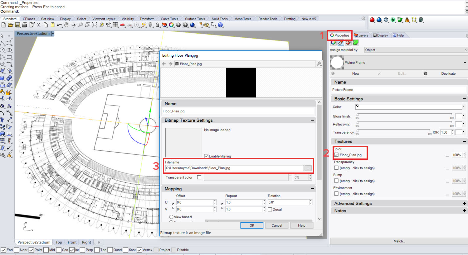

Hello Erik, thanks for catching up that one.We´ve added the missing images. You are just going to have to relink them to the proper file path. Is very easy open Properties (F3), select the PictureFrame, change to the Material property type. In the Textures panel under Color, you'll see the image file name with a three dots browse tool.
I´m attaching an image.
