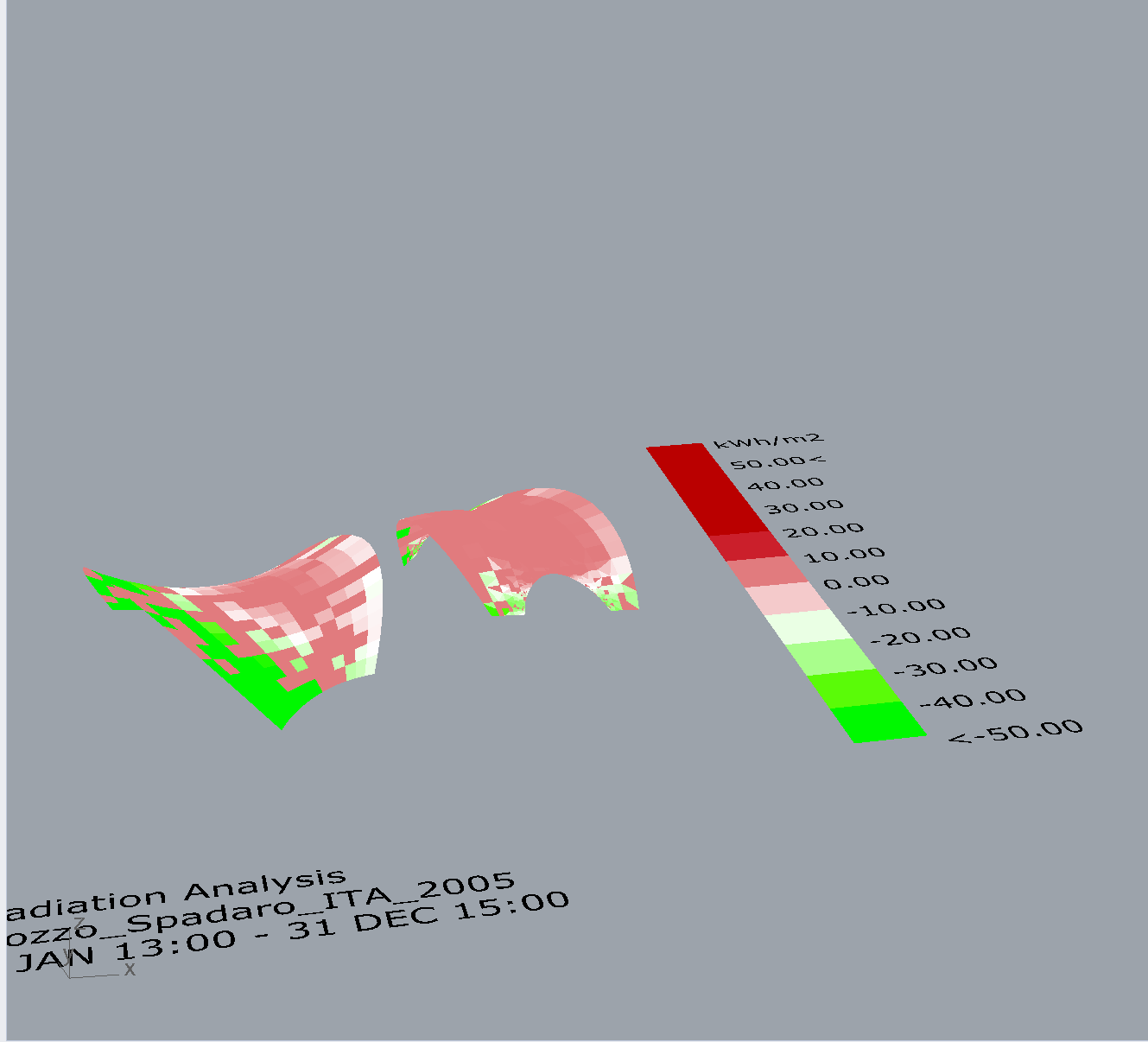

Hi Mingbo Peng, Thanks a lot for the clear and helpful tutorials. I am applying the solar radiation study however it seems that the colours in the legend are correct whereas the colours on the structure aren't, and when I reverse, vic. versa. Areas exposed to the highest Summer radiation are green when I make green my higher bound. I checked the subtraction command. Thank you.
Hi Michela,
Mm, that's strange... Is your model above the origin and also closely located near the origin (0,0,0)? Is your model in meters?
Another thing; could you check the surface orientation? Maybe flip it and run the simulation again to see if you get the correct result
