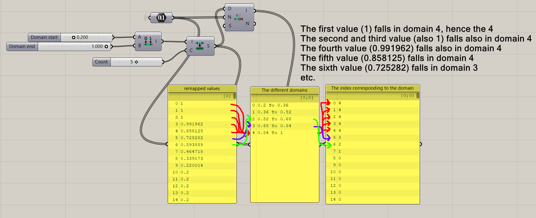

Thanks for this course, really learn a lot as a beginner. But it's hard for me to understand why replace paths is needed after we already get the scaled rectangles? Is the search mask required to connect with param viewer? And finally, why the index from the "find domain" connect to the "replace", I watched several times but still don't get it. Thanks!

Thanks for your kind words. That part of the lesson is to rationalize the outcome. So instead of having 250 different sized squares, we decide we only want 5(or 6 or 10) different sizes. There are a lot of different ways of doing this and using the replace paths + find domain is one of them.
Let's start with the replace paths component. The only thing this component does is reorganize a data tree or list. The Param viewer is just to get the path number {0;0}, {0;1} etc. from the grafted input and use as a search mask. We could also use an asterisk as we want to replace all the inputs, for some reason however Grasshopper throws an error. Using the param viewer to get all the path names/numbers for the search mask is a workaround.
Below is an image explaining the Find domain, I hope this is more clear.
