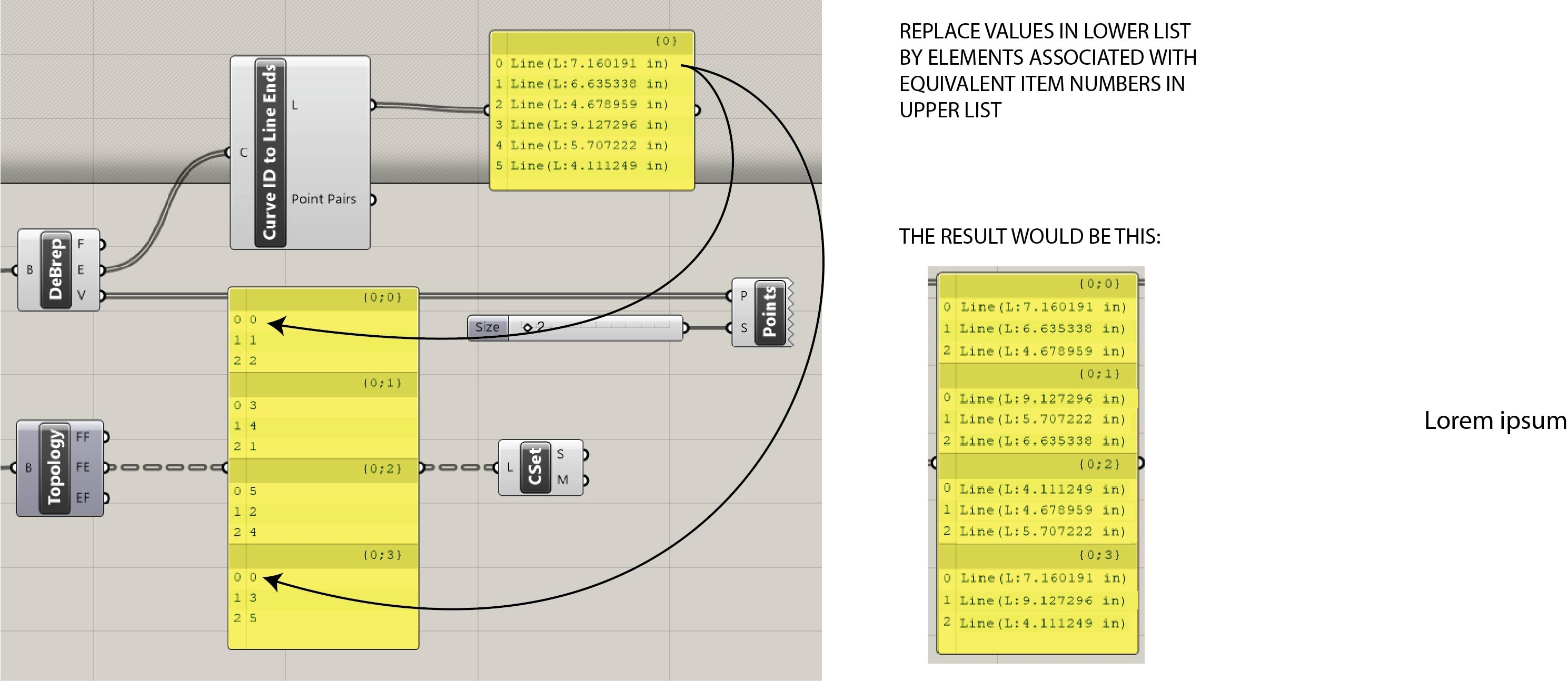

Thank you so much for these videos. They have been very helpful. Is there a way to do the opposite of the index map you use as an example at the start of this lesson? In other words, how would one start with a list of mixed integers and replace them with, for example, points (i.e. x,y,z, coordinates) or text?
Hi Mike yes this is possible, thanks for your question!
I'm attaching an image on how to do this, let me know if it makes sense and also if this is what you're looking for.

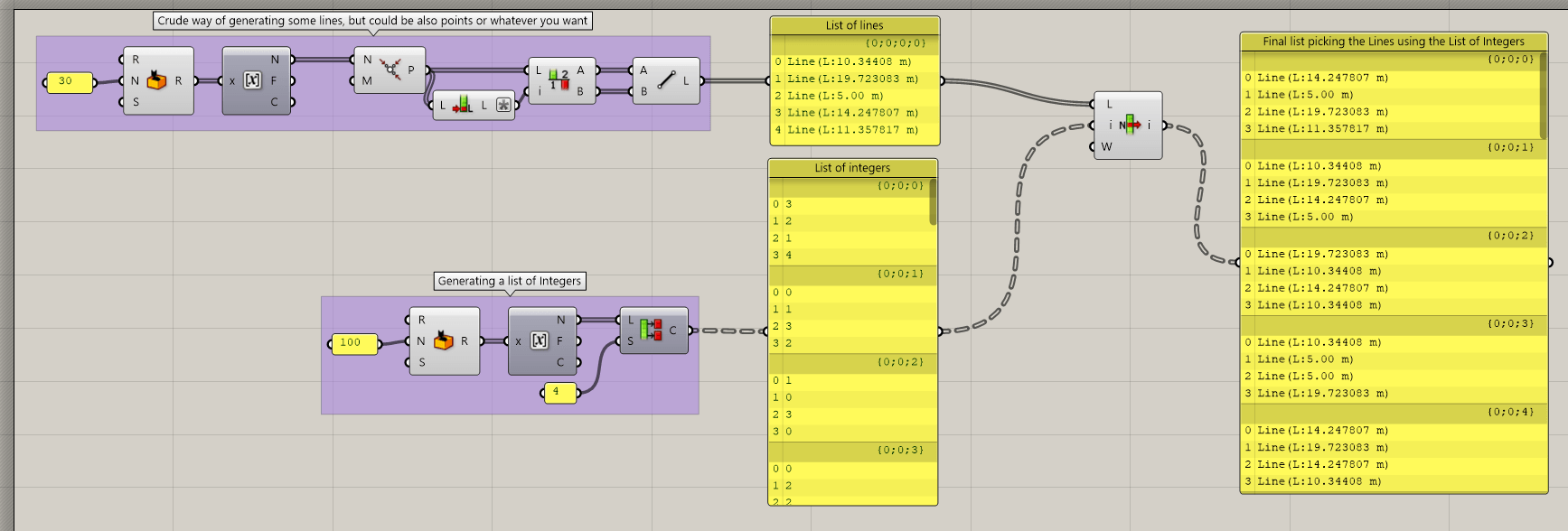

Here is a more explicit example of what I am trying to accomplish....
