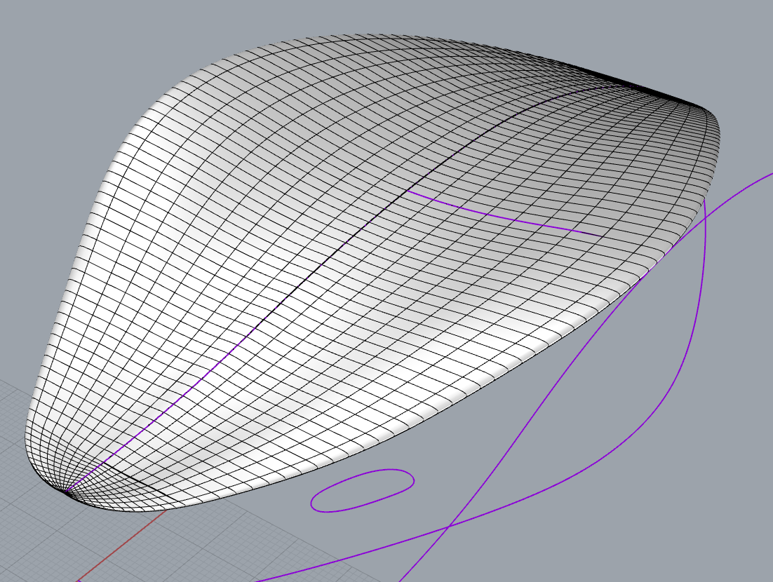

Hi, I get a slightly different result from yours when creating a surface from a net of curves. In the picture you can see that my surfaces seems "subdivided" in rectangles, while yours seems "composed" by squares. Is that relevant? Am I doing something wrong? Thank you

i had the same problem but if we set the tolerance of both the edge and interior curves to 0.001 it works out

Hi Oliviero,
Great question! Those lines you see are the isocurves from the surface. The amount and distribution depends on the amount of control points from your input curves you used to generate the surface. It's not that relevant, I'd invite you to use different rebuilded curves, one with 5 control points, one with 10 and one with 50. Create the surface and see the different distribution of the isocurves.
