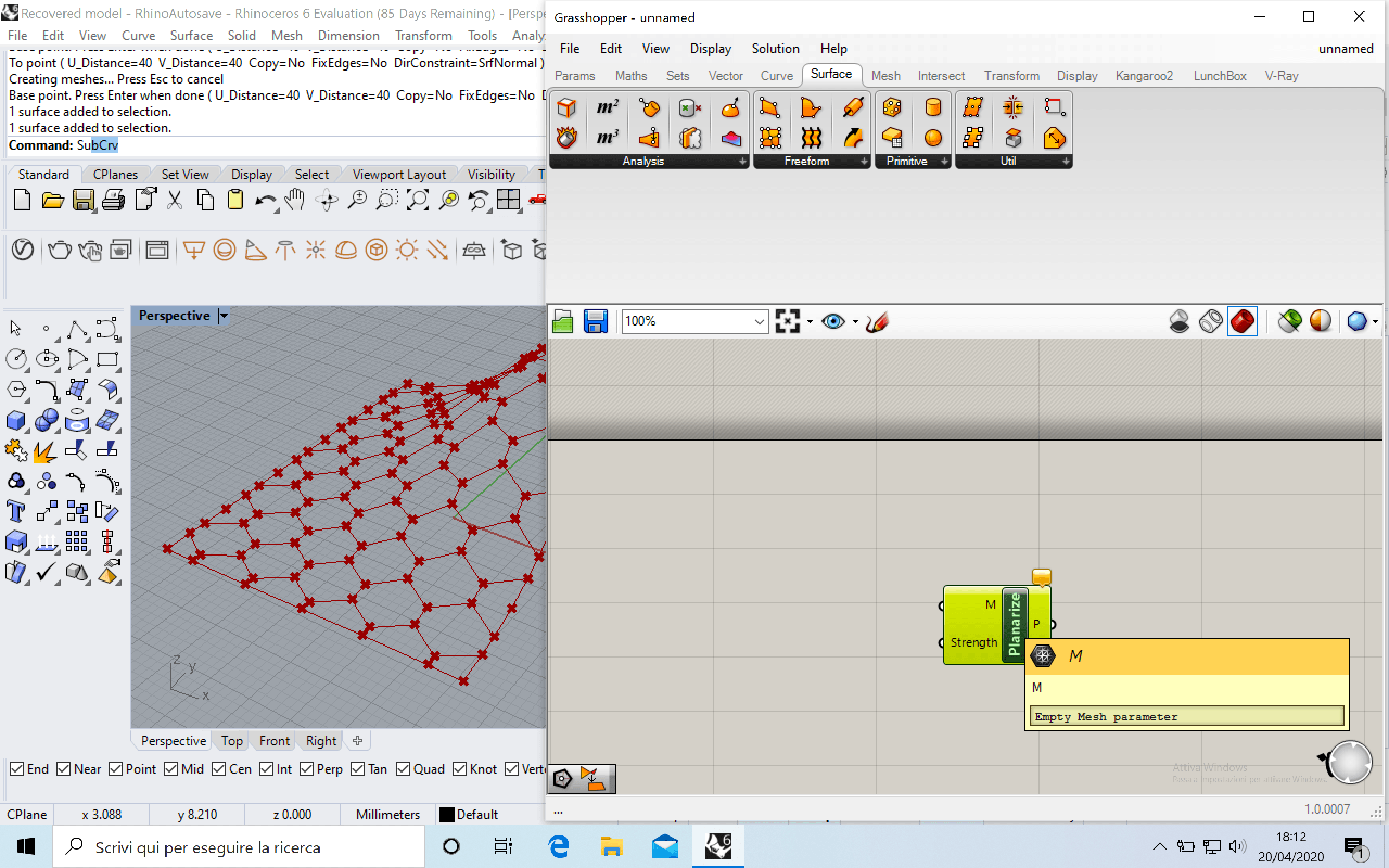

Hi, I have Rhino 6, and the imputes for planarize component is mesh, don't point like in the tutorial. How can I design a mesh from hexagons ? Thank you.
Hi Alberto,
The Kangaroo plugin changed quite a bit since this course. You can use the Coplanar component and input the 6 corner points of the hexagon.
