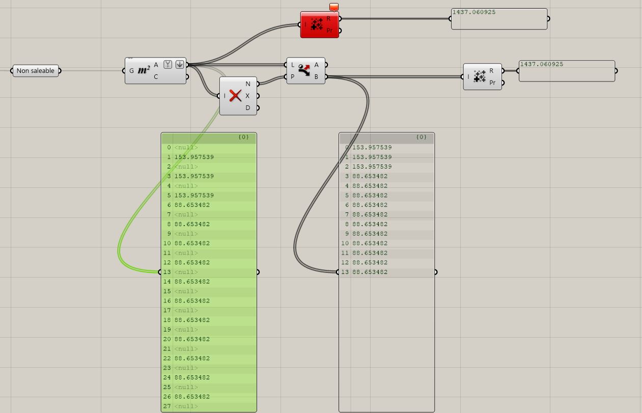

Hello Arie, In the last step, in order to get the NSA, the Areas I get from the Non Saleable data merge seem to have many nulls, and cannot perform the operation of mass addition. Any clues? Thanks in advance.
José Luis Pérez over 4 years ago
Try to avoid nulls for mass addition with _Clean Tree component.
Mass Addition doesn't like them ;)
I have also attached a screenshot with other solution.

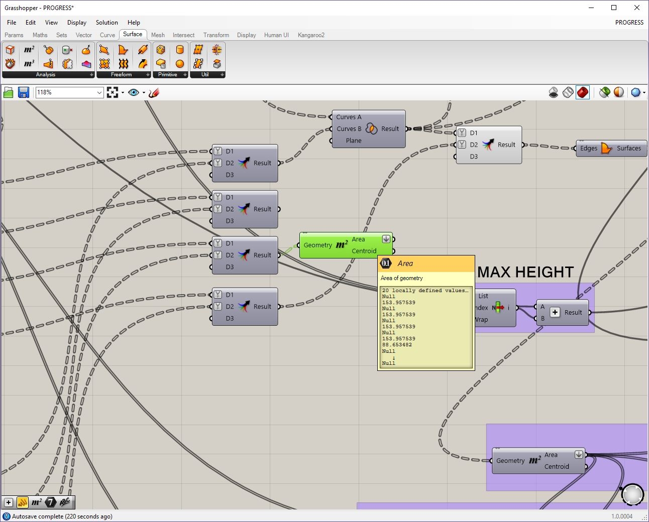

And another. Maybe you can help me out.
Thanks!

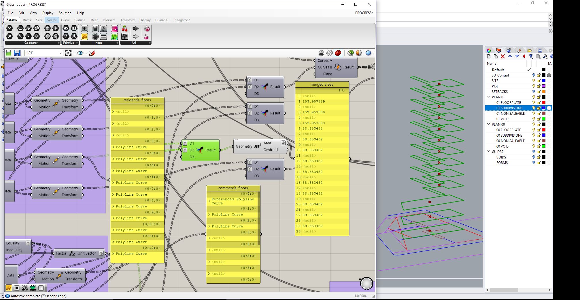

francisco about 8 years ago
This is the screenshot, I don't know why another has been uploaded.
