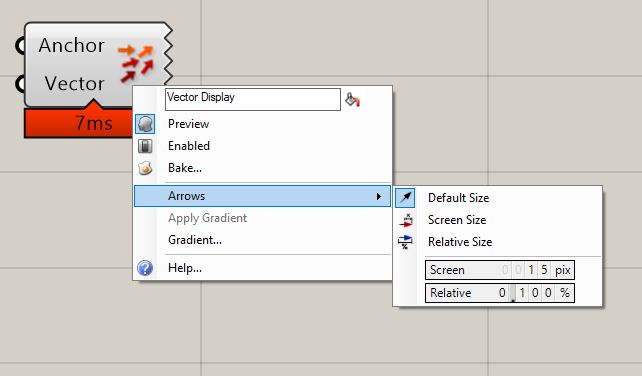

Hello Oliver and Arie, From the previous couple of lessons I understand it is becoming more and more important for this workflow to work consistently to ALWAYS check if the generated normals are pointing outwards. So i ask you: Shouldn't the vector DIsplay component have a scale feature ? Sometimes it becomes painful to read the direction that they are pointing. Is there a workaround for this? Short version: Is there a way to make the triangles look larger on the viewport?

You can increase the size of Vectors with the Vector Display component in Grasshopper. Just Right Click on the component and go to Arrows.
