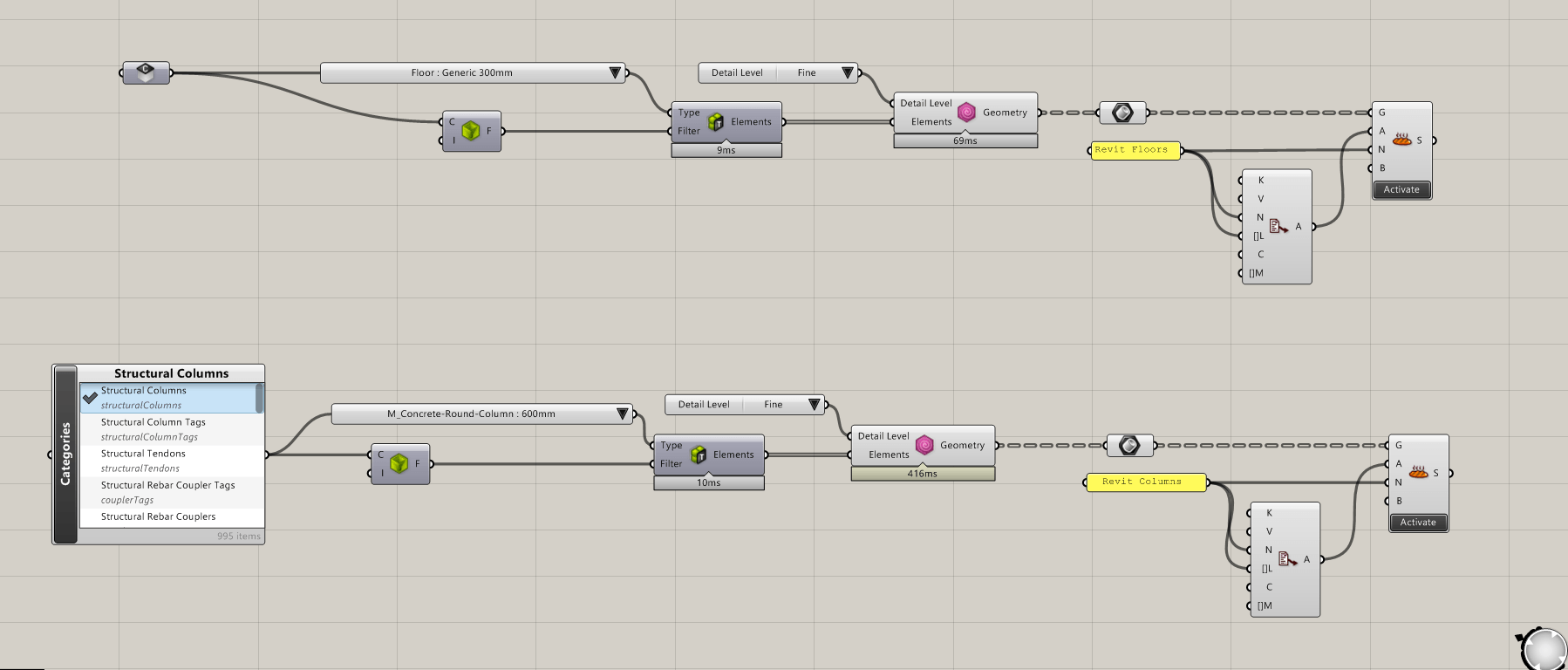

Luis Pedro Titus almost 5 years ago
Hi, I don't know if you still need help with this issue, but I figured a way to bring the elements back to rhino. Still have issues with Curtain Walls (I'm using the Storefront Revit default).
