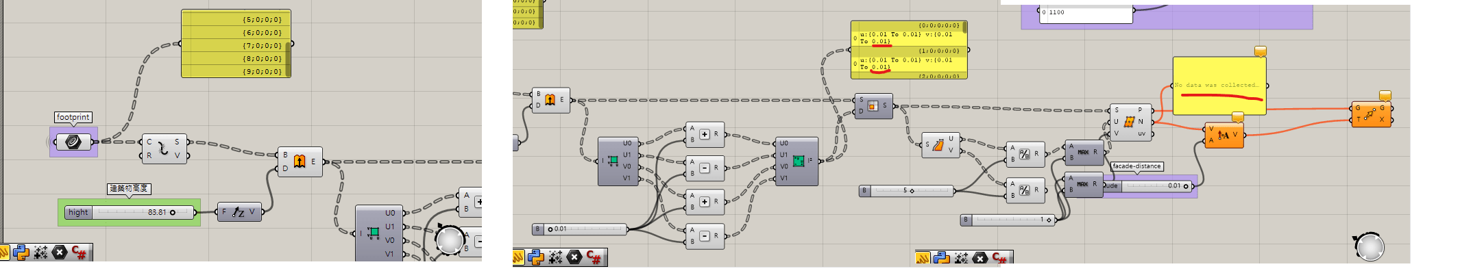

I want to use this in my site plan , but when I change the Plot outline into the other curve the data will can't be collected . Please help me ~~~~~ Thank you so much!

It seems that your "footprint" Curves-component (all the way in the beginning of your image you posted) is empty. In other words, no curves are inputted into this component. This results into the no data collected error.
Go back to before the footprint Curve Component and check why there are no curves being inputted there.
