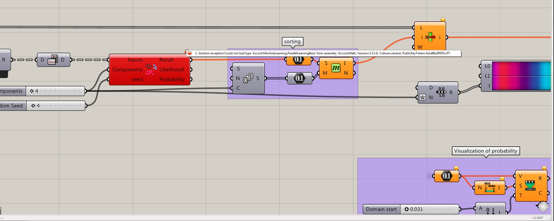

Hi Arie could you please take a look at the error message the Gaussian Mixture component gives me. Something's wrong with the access to the Accord.NET libraries. I tried reinstalling LunchBox, tried installing older versions of it to no avail; to deal with Accord.NET libraries is hard because they never have an installer - only .nupkg files. I even tried installing Microsoft Visual Studio thinking it would allow to load Accord.NET packages into the system, and it did, but Gaussian Mixture component in GH doesn't work anyways. I would much appreciate help as I can't proceed with the tutorials. Thank you in advance

Hi Arie, I tried everything in your list but it didn't help. I reinstalled LunchBox and the .dll files were never blocked to begin with... I also made a post in Grasshopper3d.com and emailed Proving Ground, but no response. May you have a better communication channel with Proving Ground? Or any friends/expert people in the forums? I cannot complete the tutorial without fixing this issue...Would greatly appreciate help. Thanks, Rustem
