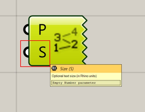

When adding the 'point list' component in grasshopper the T and L parameters are missing, and the numbers beside the rhino geometry won't display.
Can you help?
This is because the newer version of Grasshopper made changes to that component it works very similar, maybe you can't see the numbers because by default the numbers come at a very small size.
You can make them bigger by setting a different number on the Size input.
