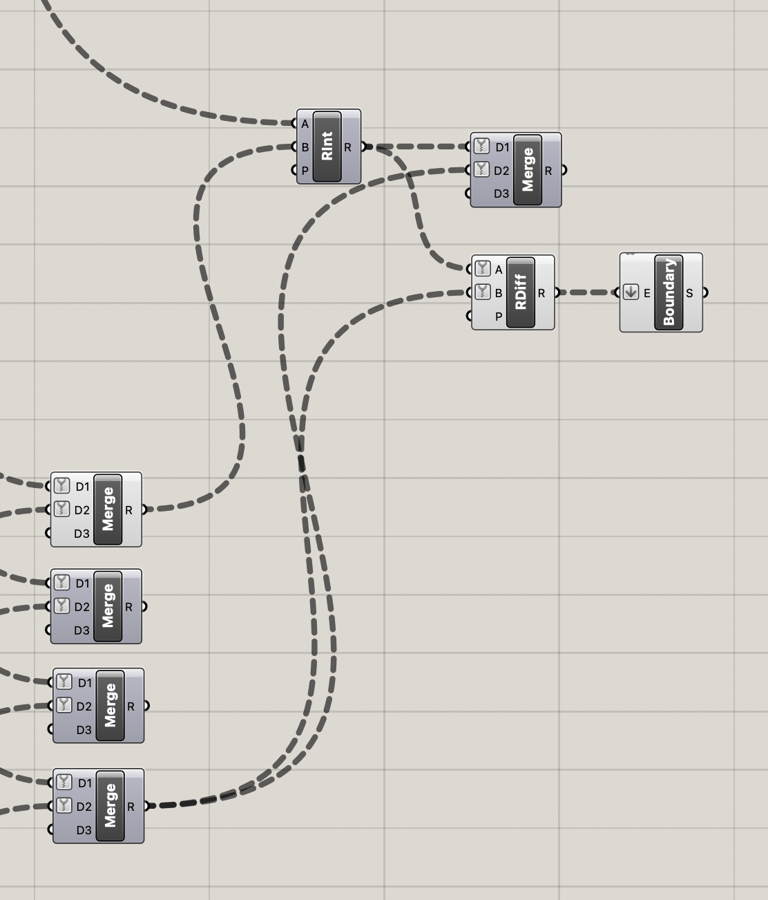

Hi, I tried using merge as shown at 4.00 in the video to cut out the voids from floor plate, but it didnt work when I developed surface from the curves. So I instead used a Solid Difference to get the same result. Want to check if this would affect any data analysis done in part 4 and part 5 of the lesson.

It shouldn't affect the results, granted you didn't flatten any lists. Make sure you the surface area from the surface (and not the curves), just to be safe.
