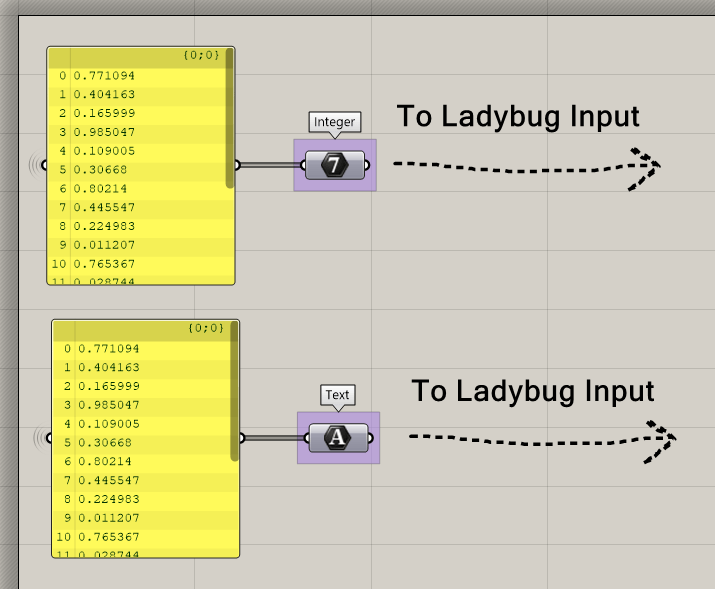

Hi! I have followed all the instructions but when I run the Radiation Analysis I get this error "1. Solution exception:unsupported operand type(s) for -: 'str' and 'int'". I have flattened the merge result. Thank you! P.s. The courses are great!
Hi Mauro,
I think either you're inputting Text (Strings) into a Numbers (Integers) input or vice versa.
Try putting a Text-component before the Ladybug input (if that input requires Text) or
put an Integer component before the Ladybug input (if that input requires an Integer).
See image
