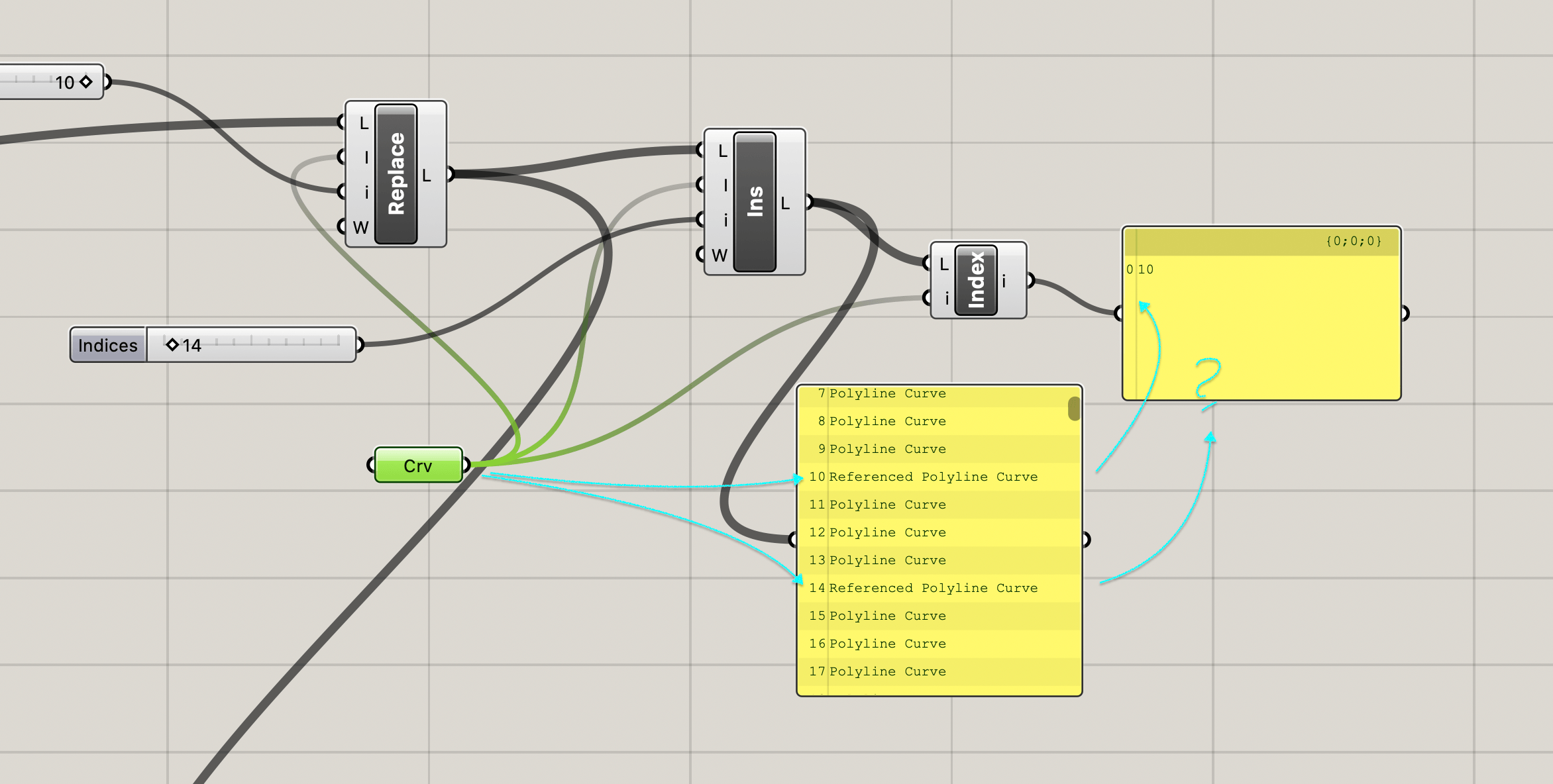

Here is my code: I have curve on 10th and 14th position in my list, but Index Item shows me only the first one.

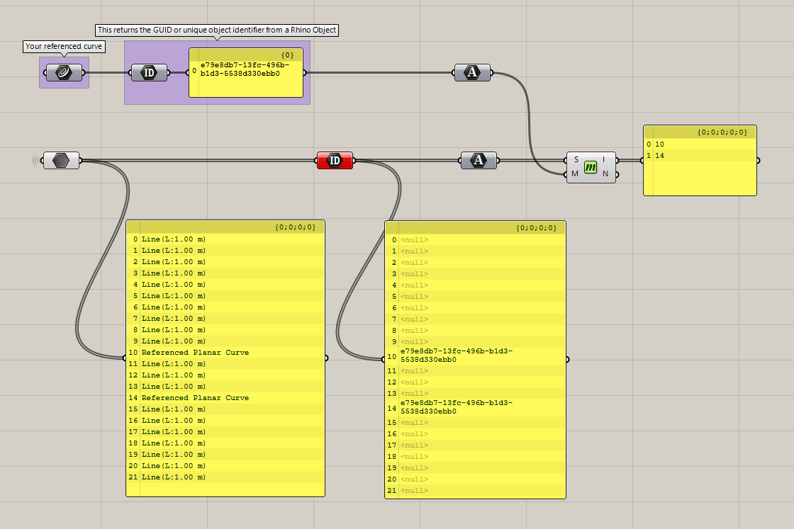

Hi, great question! See the image below. The problem with that component is that it only returns the first result.
This solution should work to find any instances.
