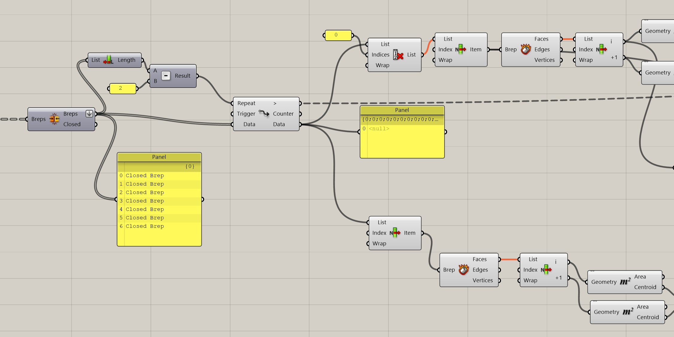

I get all the get all the geometry ready and then the data is not coming out into the loop. Why?
Arie Willem de Jongh over 6 years ago
Hi Ross,
Connect a Boolean Toggle to the Trigger and switch it on and off a couple of time. This might resolve the issue.
Anemone isn't flawless and sometimes it will output Null values, I'm not sure why.
