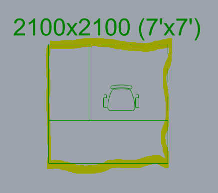

I have a block consisting of only lines in Rhino. How do I get an outline with grasshopper? I tried Human block reference functions but nothing is working

Hi Arie,
Sorry for the slow reply. Here is a clip of a block that consists of lines only. I want to extract the highlighted lines so I can offset them. I don't want to explode the block because eventually want to use the block as is.
Hi Umid,
I also couldn't find it in the Human toolbar. You can create blocks but I'm not sure how to reference them.
Anyway, if you use the Elefront plugin you can do it: https://www.food4rhino.com/app/elefront
I wrote a small script: https://mega.nz/#!4V9zTbyJ!8nOFXHeNchQ3V7WWJiLur5yDCqZIun_-Q99k5mrbkRw
P.S. You need Rhino 6 and Elefront installed
Good luck and let me know if it worked for you
