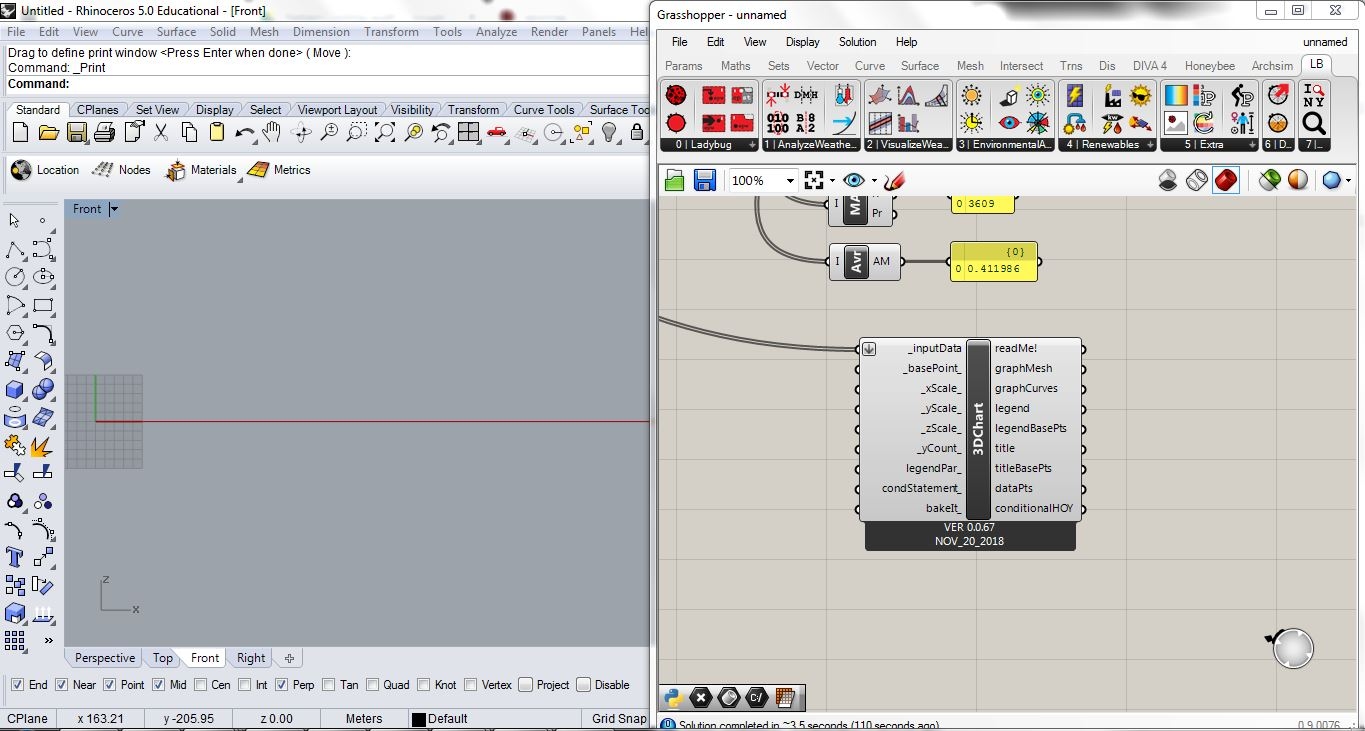

I followed the steps to achieve 3D chart but it has generated a 2D chart instead.
mj cardona over 6 years ago
I have the same issue. When I switch from the top view to front view or perspective view, there is no 3d of the graph. Please advise. Thank you very much M

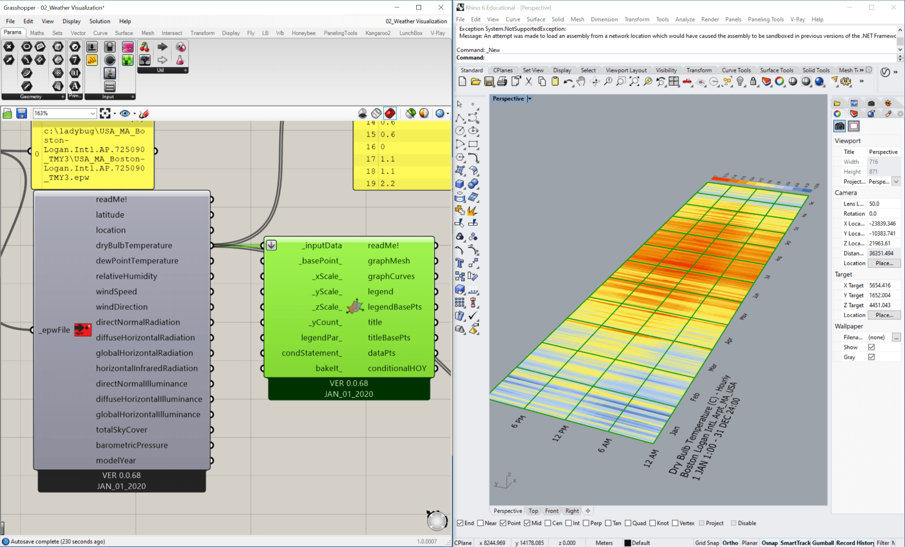

Disregard. It appears that the latest version of ladybug sets the z scale to zero right off the bat and that is why there is no 3d view of the graph as you follow along.
iason.bournas almost 7 years ago
You need to switch the Rhino view to "Perspective", i think
Hi Vini,
Is there data to display at the hours you selected? What happens if you change the Legend input to another domain?
Dinisha Dinesh over 5 years ago
its still 2d for some reason. is there a way I can project the data in the z-axis or something?
