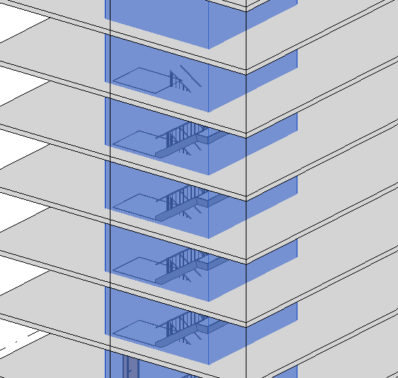

Hi! I’d really appreciate some help here! I’m on Lessons12 Stairs, Railings & Shafts from REVIT Architecture 101 course and I have an issue with the Shaft, I am not able to cut floors with it, and I really don’t know how to solve it. Thanks! P.D. I’m using Revit2021
Hi Diego,
Please check here: https://knowledge.autodesk.com/support/revit-products/troubleshooting/caas/sfdcarticles/sfdcarticles/Revit-Shaft-opening-not-cutting-slab-edges.html
There is a specific order in which to create slabs and shafts.
Diego López about 5 years ago
Screenshot attached
