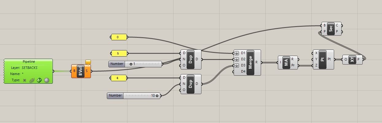

Also the cutting of floor plates does not work. I could only see one X Mark. I am just making a simple 5 sided volume
Hi Karlson!
Unfortunatley, this appears to be a bug in Rhino v6/Grasshopper 1.0.0005 : https://discourse.mcneel.com/t/bug-boundary-volume-doesnt-work-properly-in-v6/63663
Could you try to update your Rhino/Grasshopper to the latest version? https://www.rhino3d.com/download
Let's see if that works
