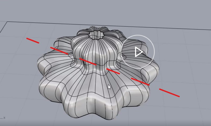

for example : i want make it just a half of the mass or 30 degree or it...

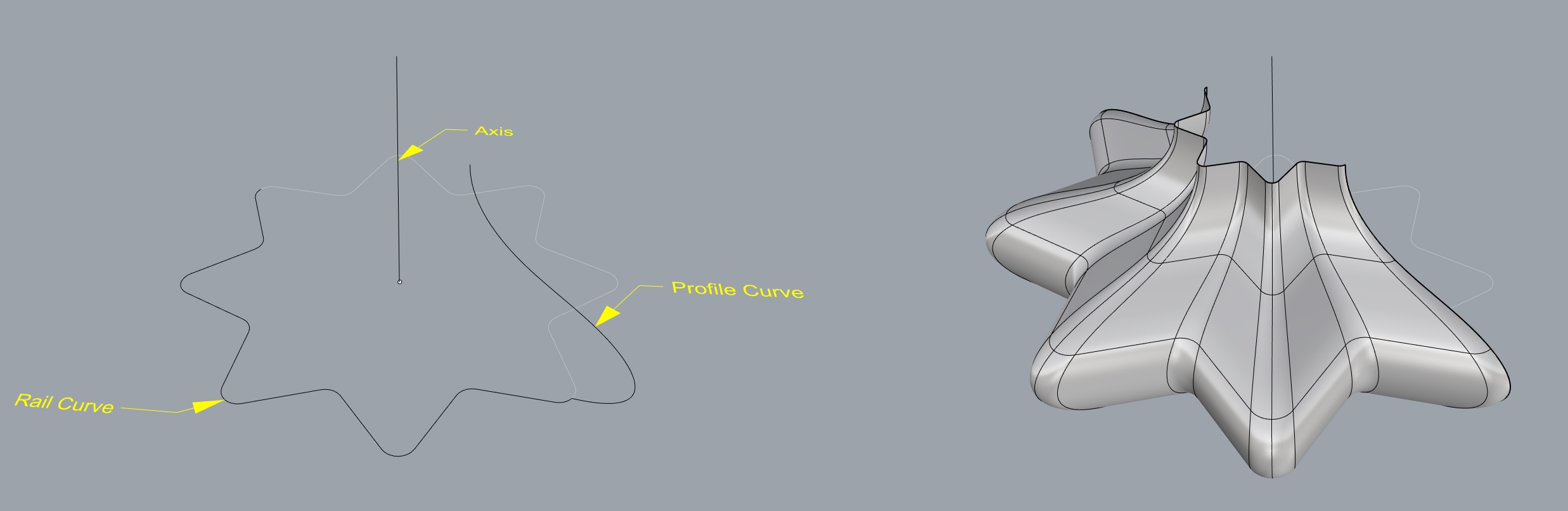

Hi Andrye,
Great question! So because your using a rail curve to revolve, you can't specify an angle unfortunately. What you can do is to adjust your rail curve, for instance if you want to revolve just 'half' see attached image:
