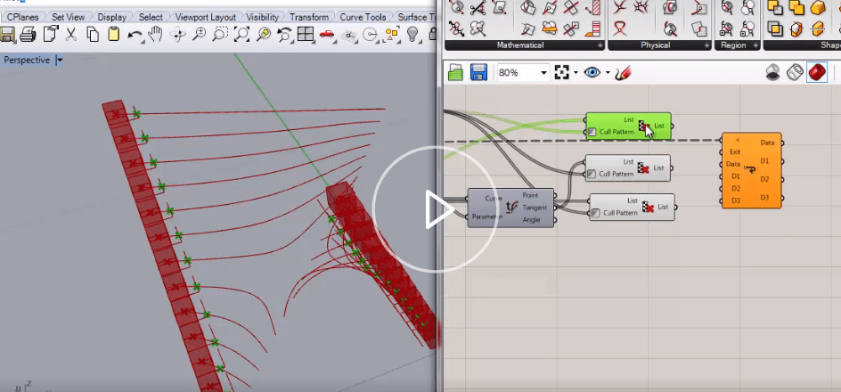

Hi there, thanks for the lesson. Wanted to ask could you please explain how the "Null item" component outputs can be applied to all the "Cull Items": for the points, lines, and tangents ? So do the lines, tangents, and points share the same index ? The part of the video for this question is at about 11:00.Sorry it was kind of fast, although detailed....Would really appreciate the help and the explanation,Thanks

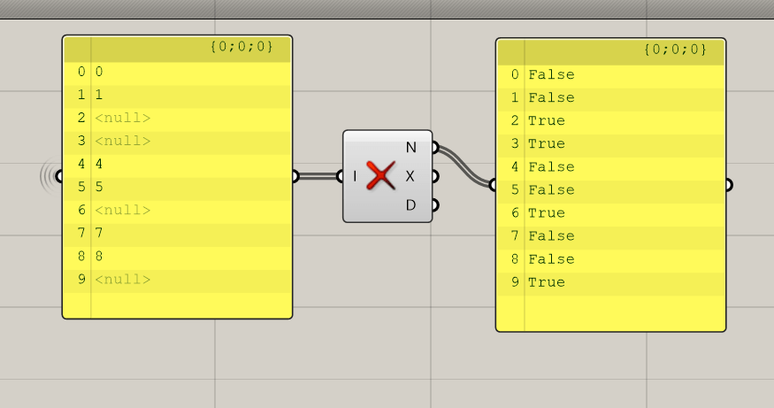

Hi Loke,
The Null Item component checks a list for entrees that are Null or Empty. It returns a list of True and False items depending if the input entree was Null or not. See attached image for more clarity.
