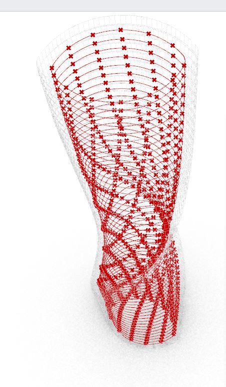

I'm trying to connect the list of points along these points to make columns that follow the twist. Thanks in advance.

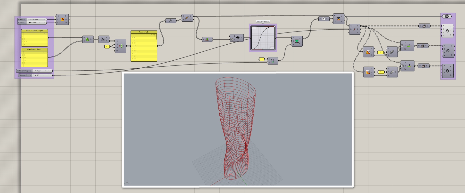

Hi Ram,
There's a lot of ways to achieve this. One way to go about it is to divide the ellipse into a set of points and then copy/rotate them up.
See attached definition:
https://mega.nz/file/BF1lSZCA#7TXvdizTCKJ_lCD0eGkfevPTOlIUw8oKI81yAU38nh4
