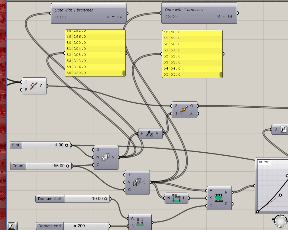

Hi, Why is the second Series necessary? I understand that the step input may not be necessary for the Remap, but does this matter? I got similar results by only using the first Series.
Second series has a range that starts from 0 to 56 this is equivalent to the number of floors we have which we will use in order to get our rotation per floor when we remap our numbers
