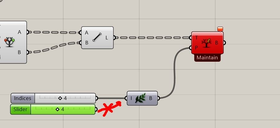

Hi, when i'm conecting the 2 slider to "Branch path" just one of them stay connected. What do i have to do?
Hi Angel,
Hold your SHIFT key while connecting, you'll see a plus appear to connect multiple wires. Vice Versa if you have multiple connected wires and want to remove just one, hold your CONTROL key (a - will appear next to the cursor) and you drag the wire to remove it.
