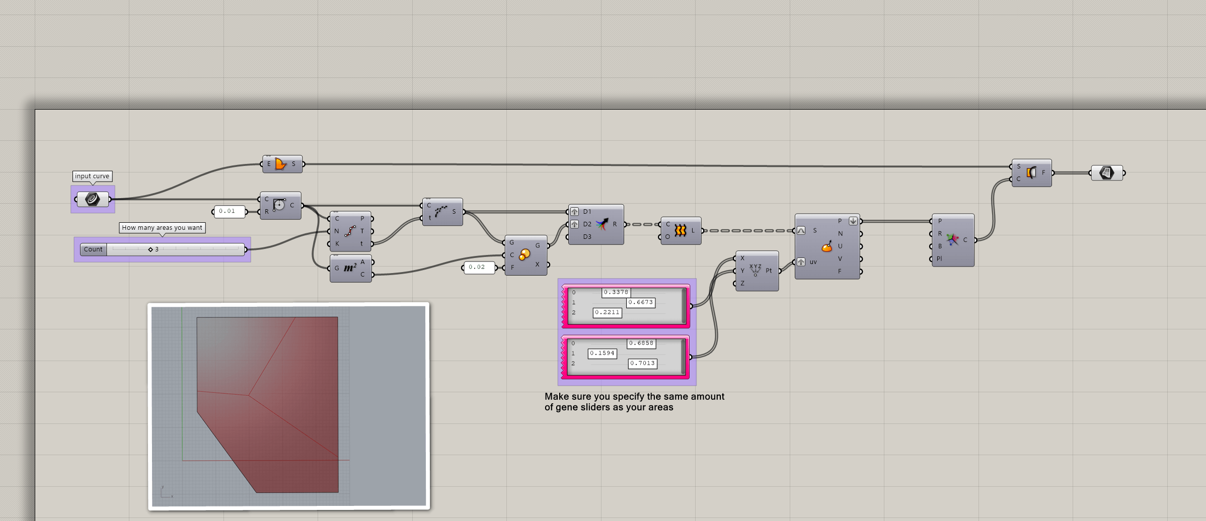

Here how to control the number of areas , what if i want to divide the surface into 3 parts instead of 5 , can you please guide me into that .
Jose Barba almost 7 years ago

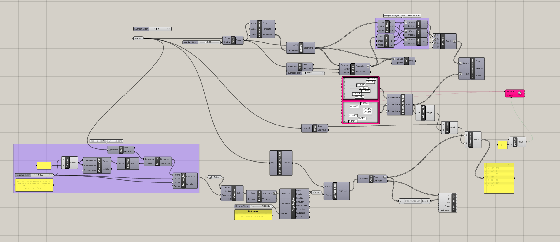

Hello,
I tried the definition and it didn't work. I have to change a couple of things: the loft part didn't work for just one Loft component and I had to set a rectangle for the Voronoi boundary diagram. I'll leave the definition attached, in case someone had the same problems.
I tried dividing the original surface in 7 parts. However, after 500 iterations I got to a result that it's not so accurate as the example shown in the video (maximum deviation of the ideal area of 19 mm2 and maximum difference between areas of 31.26 mm2, being 5868 mm2 the total area of the original surface, meaning the result is way better of what we can achieve by hand anyways).
Hi Jose,
Looking at your definition, you use 7 gene sliders for 7 surfaces, that's correct. But you didn't set the initial slider to 7 (it's set to 3). Maybe this is where it went wrong? Could you send me an image of the shape of the outline you're using? Unfortunately if the outline is a complex shape it might also not work correctly. Nevertheless send me the outline and I'll see what I can do.
