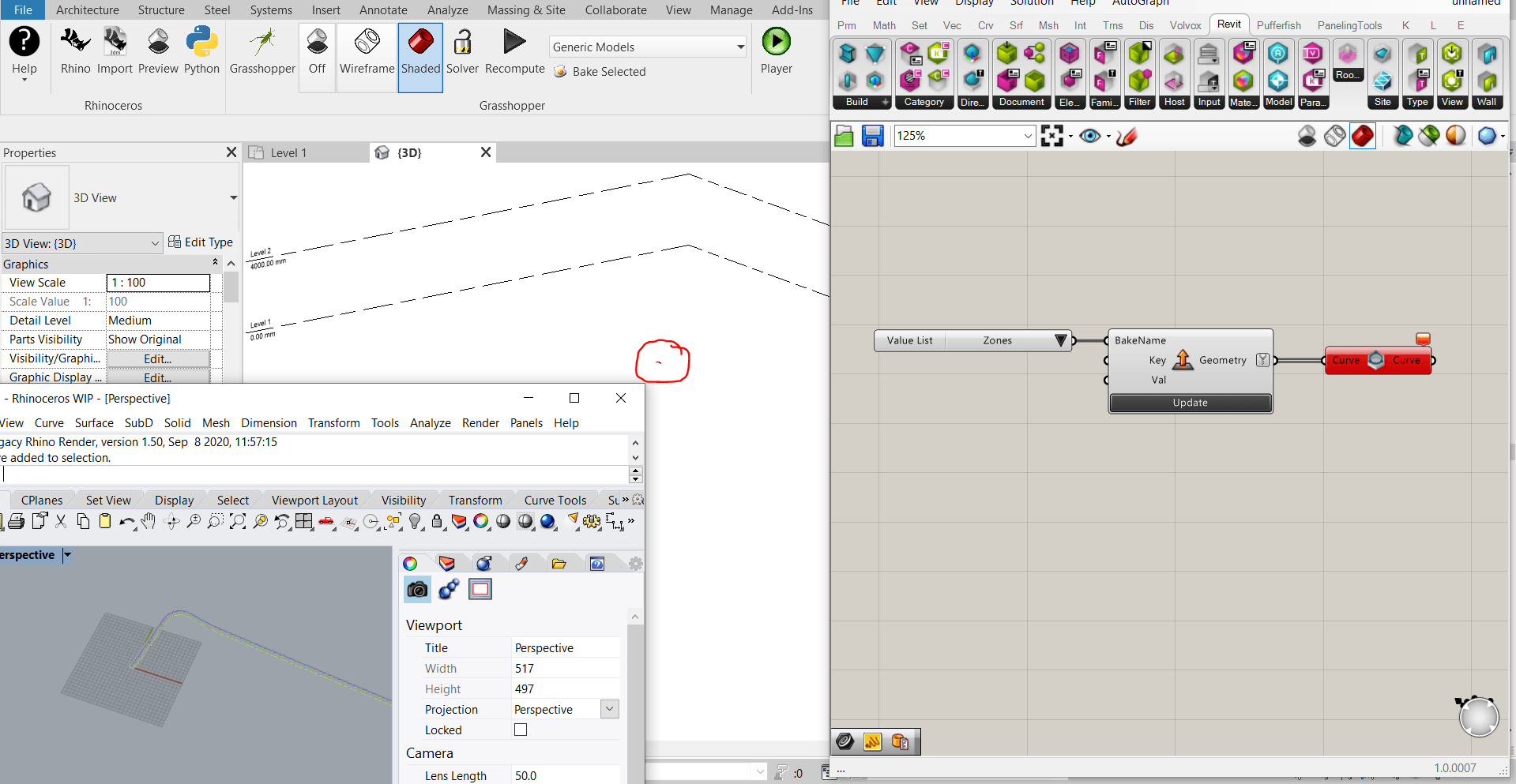

When I am working with rhino.inside, in my rhino interface it looks perfect but unfortunately in revit It appears very very small. Could you please help me with this? Previously I was able to create curve perfectly and also it was not giving error. I can send you my project files.
Hi Parmial,
The scale of your model is set differently in Revit and Rhino. Check your Unit settings in Rhino and Revit and makes sure both are set to Metric (or Imperial) and next make sure both are set to Meters (or Feet).
