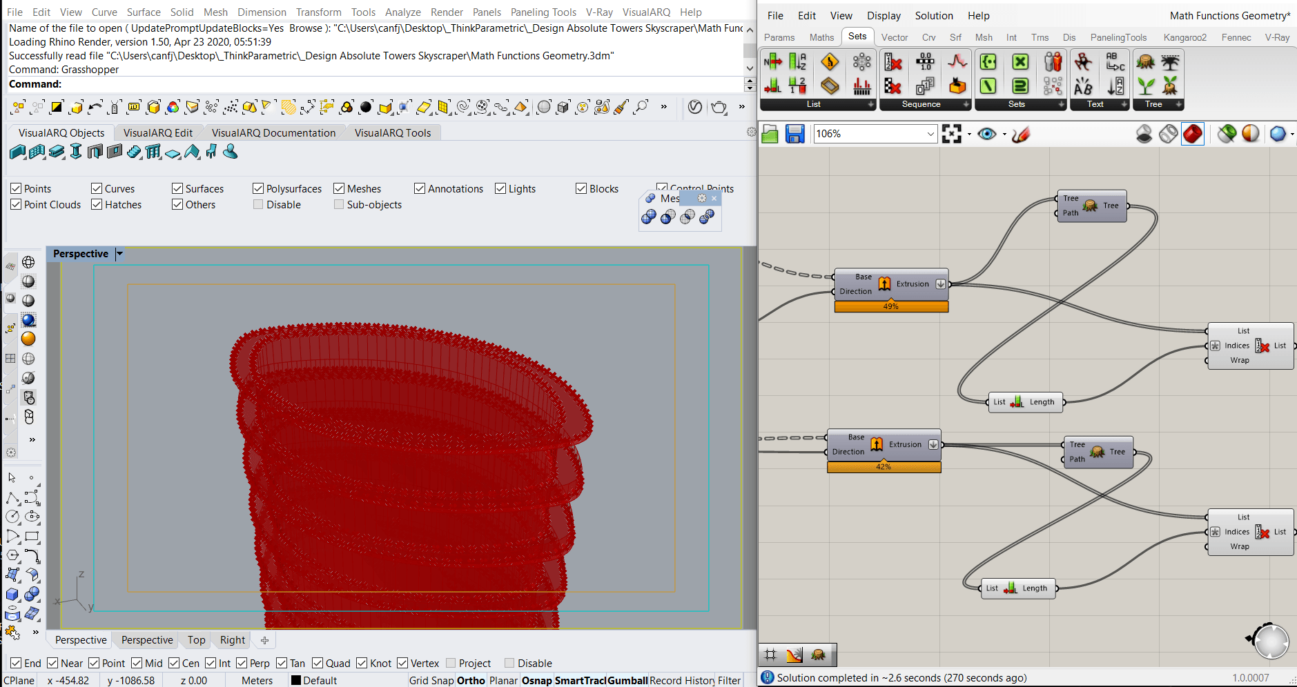

Hey Rodrigo! First of all, very nice tutorial! I managed to understand it quite well overall thanks to the very well explained first modules (101+102) that went through all the components you used! However, I am having a bit of difficulties in removing the last glass panels and Railings IF I am using the (RAM consuming) subdivided panels! On the other hand If it is just simple curves extruded then the x-1 functions just fine. So my question would be: How to remove the last level of Glass panels and railings if I have divided these elements ? I think I can foresee that the problem is the data structure which seems to be too complex (many layers of depth) but have not yet found a solution for this! Thanks in advance!

Hey Rodrigo! I finally found the solution!!
For it to work I had to flatten the extrusion and add a Flatten Tree component in between "list length" and "cull index" x-1 !
