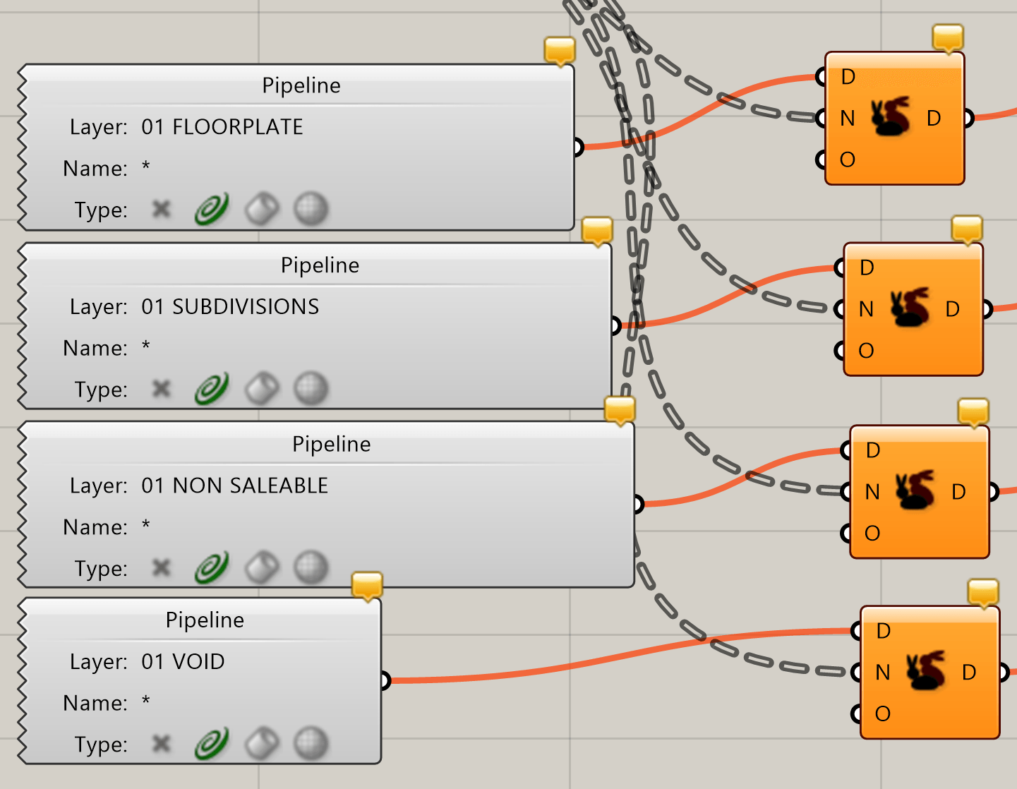

Don't why it gets wrong when I connect these two. Any help? Thanks!

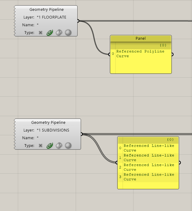

Don't know if this is your case but maybe it has to do with something that got updated within GH (newer versions)
I only managed to use Geometry Pipeline if I replace the "0" for the "*" character even though the layers are called 00, 01 etc
in short:
00 becomes **
and 01 becomes *1
