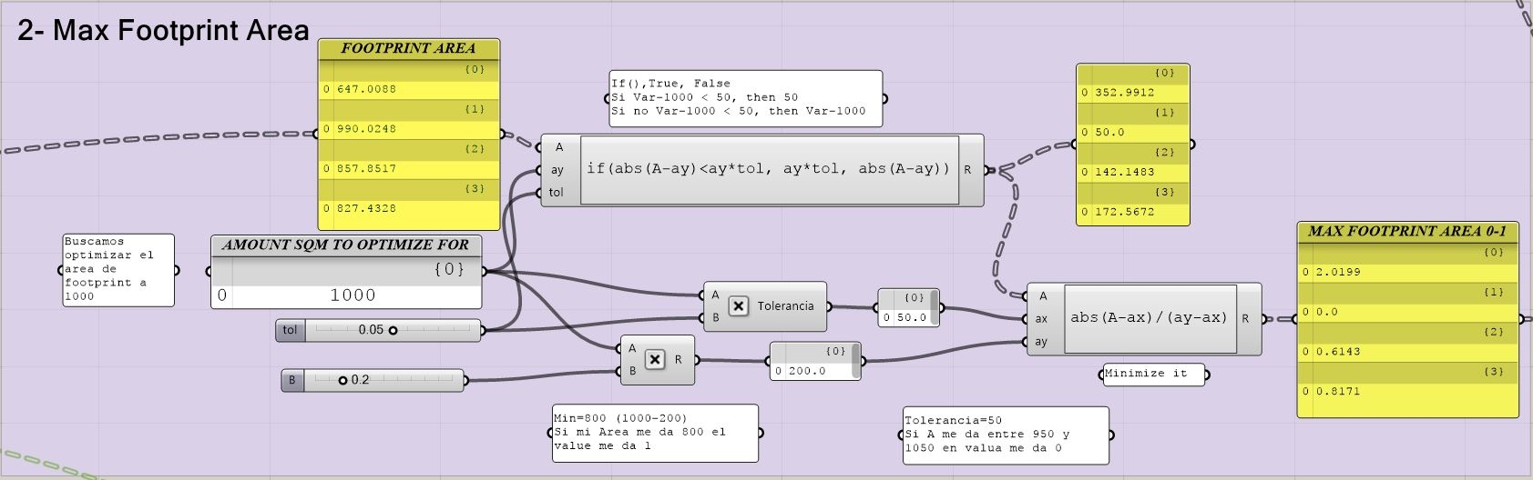

Hello Arie, I have more or less understood this part. What I do not understand is why minimize the footprint area? It is not better to have more area for the spaces? Anyway, my problem is that with the given definition, it is not normalizing the values. For those areas below 800 it is giving me a number bigger than 1. See attached picture
