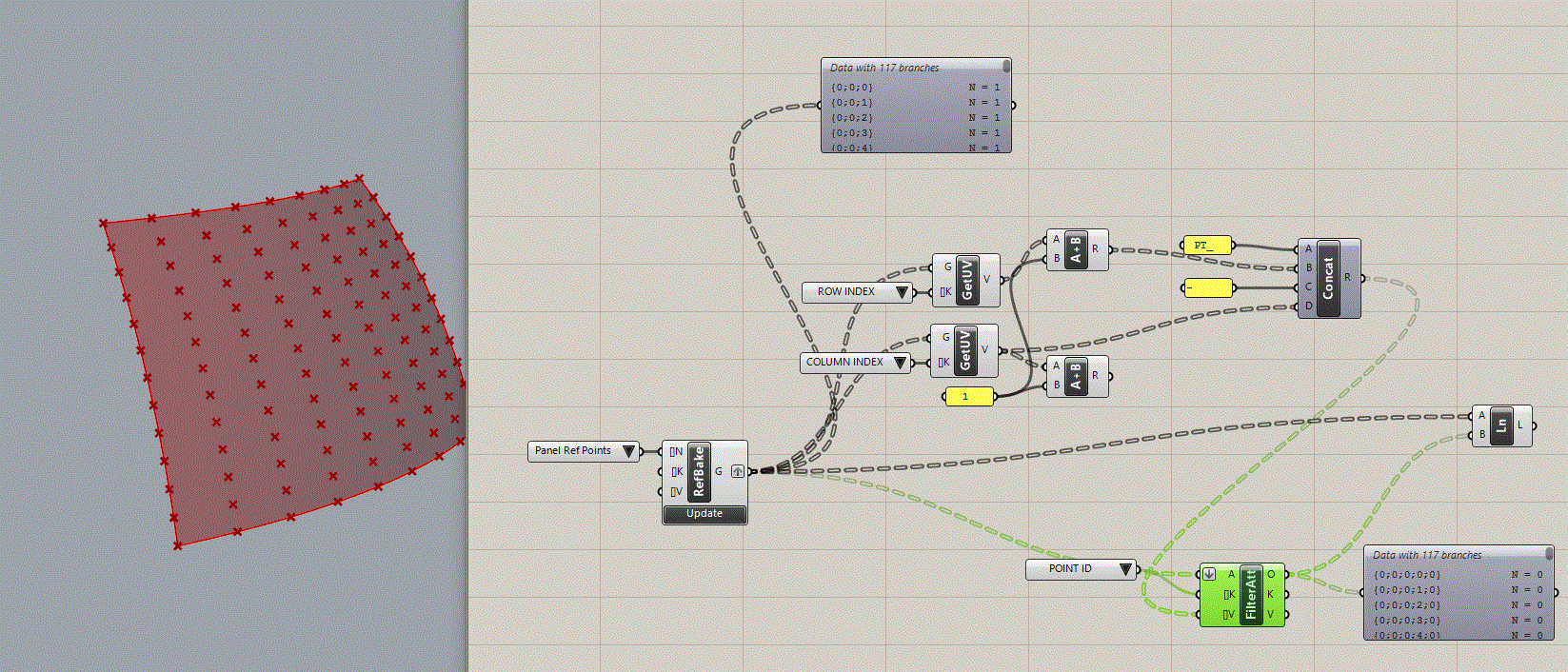

(11mins) The tutorial on advanced filtering of elements by user attributes advises that connecting the concatenate command (which is taking the row index +1 and the column index) to the filter one should result in a number of points being selected by the filter. When I do this the for some reason no points are showing up however I have checked a number of times and cannot see what might be going wrong. Upon connecting the line tool back to the original points and the filter at this point no lines appear (whereas they were showing multiple lines previously when applying a value list to V rather than connecting the concatenate command). Any ideas what I am doing wrong? thanks,
