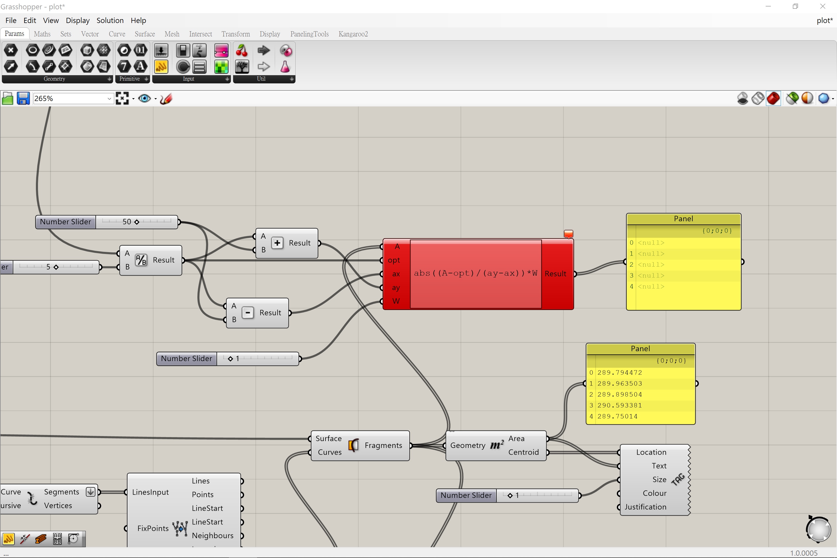

i just follow the instruction in the tutorial but it just failed all the time.
Hi Roi,
I think you inserted the wrong objects in the A input (the Surface Fragments). You have to insert the Area of those Surface Fragments, which are the m2 from the Area output that comes after it.
Good luck!
