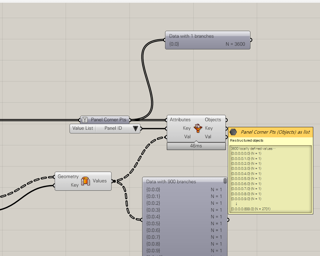

Hi, I am in session 9 and met a problem. After filter Att from the Panel Corner Pts, the param tree shows 600 branches but branch 0 to 598 contains only 1 item, branch 599 contains 1801 items. (based on 20 column & 30 rows). I noticed that my column index starts from 19 back to 0 instead of from 0 to 19, my row index stars from 29 back to 0 instead of from 0 to 29, which is the only difference. I was wondering how to fix it? Thanks!

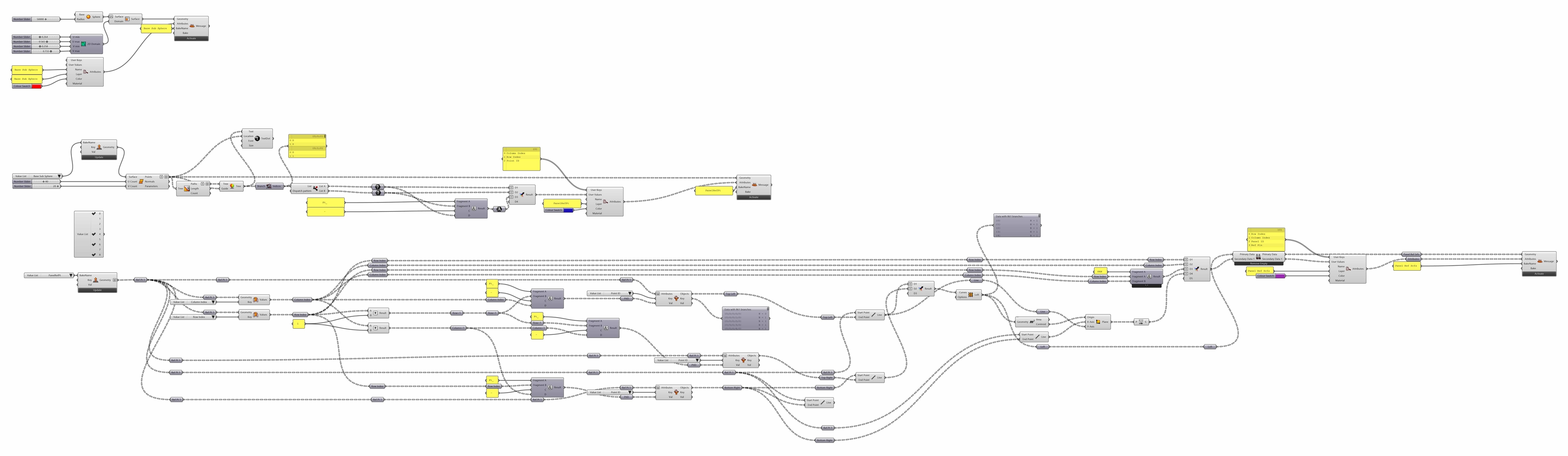

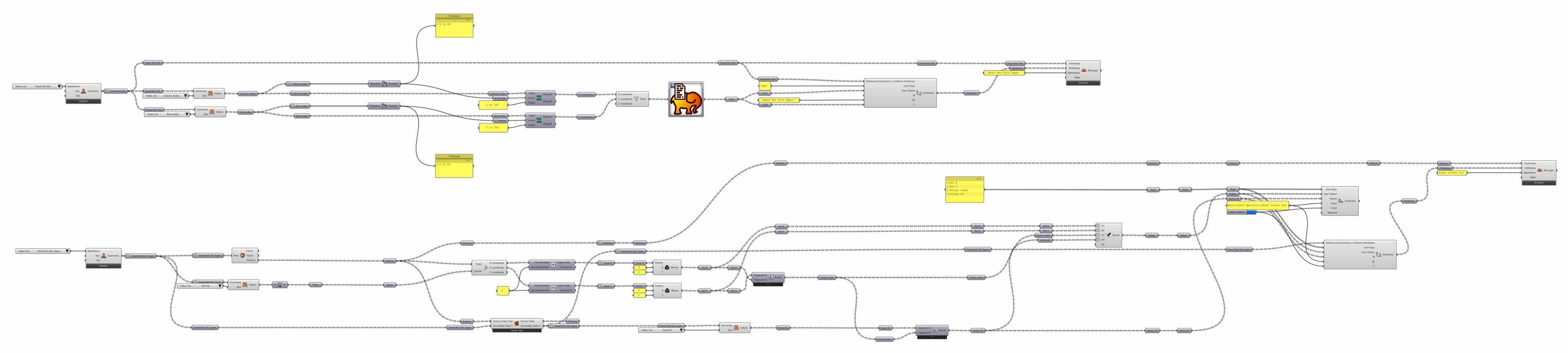

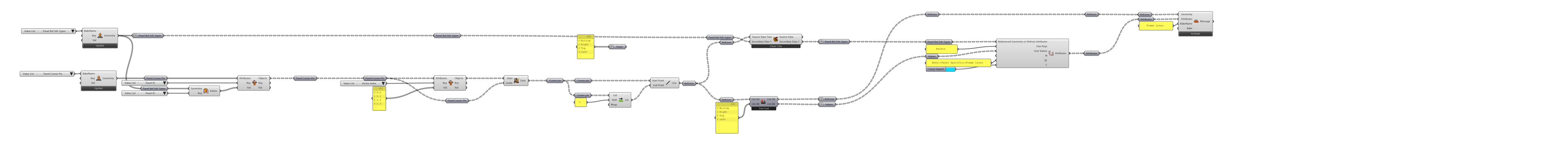

Hello Emma.
I just went through the lesson and I think it works as it should.
Here are all my definitions (in three parts/jpg). Hope it helps!

It seems that your []V input is grafted and your A input is not. What happens if you graft your A input?

I graft A input which takes about 1 minute to calculate the result.
It ends up with 1440000 branches. It seems it is not the result we are looking for.
