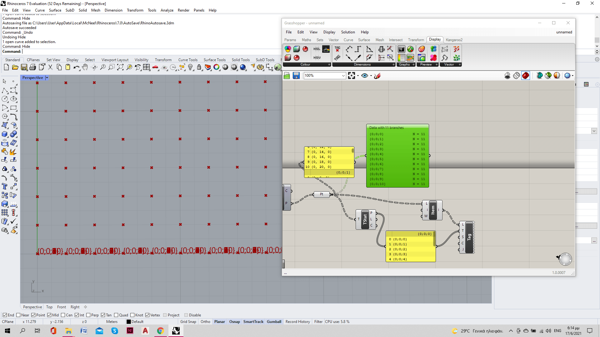

Also If I plug my text component at the points component and the related panel the points of the first row seem to be in the same branch {0; 0; 0} and the letters appear normal on my viewport, but if I then plug the text component at the list item (as suggested) component and Tstat, the letters are overlapping on my screen as shown at the photo below and also the points of the first row seem to be each in a differend branch.. 1. Why does the sructure change when we plug in the list item component+ tstat? I feel I haven't comprehent something..2. Why does the letters overlapping on the second case only? Thank you in advance :)

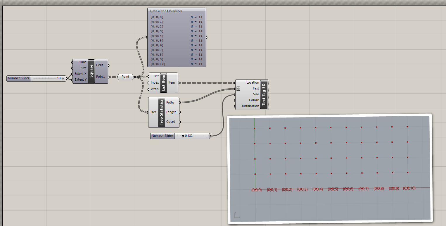

Yes, Path and Branch mean the same thing. A Path is referred to as a Branch as a Tree metaphor. As in the Tree is your whole data structure with different inputs (in your case 11 branches) and the individual Branches hold all the individual objects (in this case 11 points). So yo have 11 points per branch and in total also 11 branches. It is the way Grasshopper organizes and stores more complex lists of data. It is hard to grasp in the beginning, it took me also some time to understand it also with the weird curly brackets and semicolons. But this is the core of Grasshopper, unfortunately. It is paramount to understand this if you want to create more complex definitions in Grasshopper. We're updating this course as we speak and we're trying to look into a way of explaining this the best way possible.
The reason the text is overlapping is that you're inputting 11 values per branch. So what you're seeing is 0,1,2,3,4.....10 all overlapping per point. You have to graft the T-input (create a branch per input) for it to display correctly. If this sounds like mumbo jumbo, please check out https://thinkparametric.com/courses/grasshopper-102-data-lists-and-tree-structures/ I explain a bit more in depth how data and lists are organized in Grasshopper.

I've included a screenshot to display the text in a correct way
