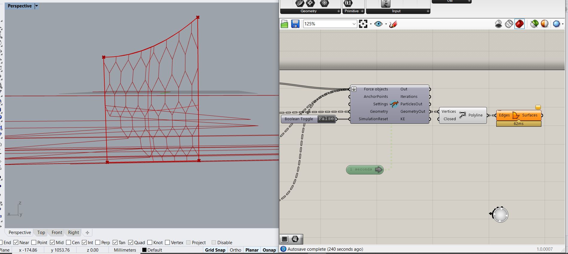

After Toggling the Boolean Value to True i am getting very distorted polylines and am unable to make any planar surfaces. Unsure as to what is happening here, hope you can help? Cheers
Hi Wombat,
Try lowering the value of the forces you use. Usually the system gets a bit unstable when (one of) the forces is/are very high.
