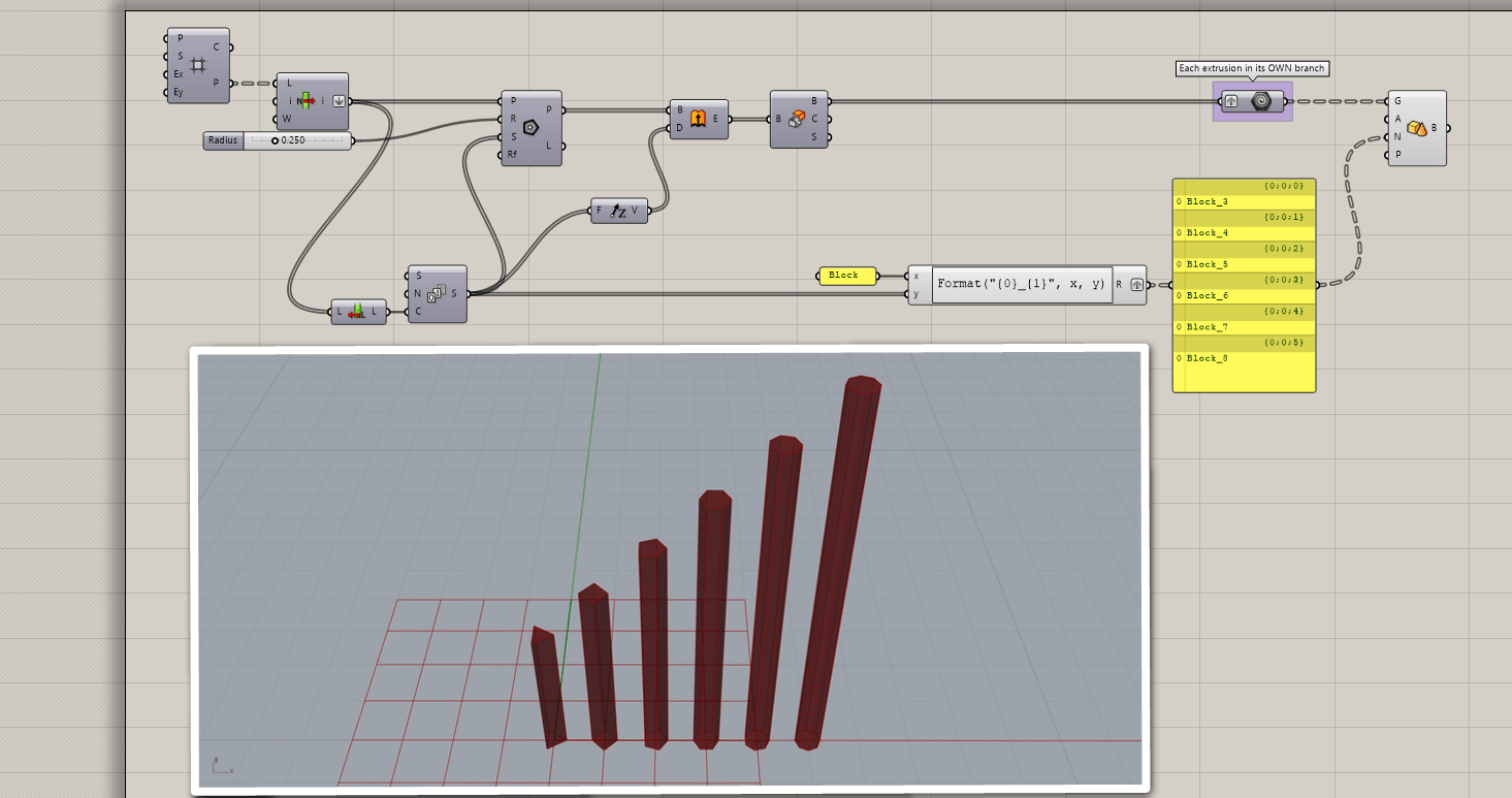

Hello Ramon. Is there a way to define multiple blocks from a list of created geometries in grasshopper? For example, i created 6 extrusions and instead of manually creating and copy pasting Define blocks, i could somehow automate it maybe adding a variation in the name of the block e.g. Block 1 , Block 2
Hi Jobriel,
Yes you can using the Define Block Component. See attached image. Make sure all the elements you want to include for a Block are in the same branch.
Also you need to specify a different name for every Block and put that text also in branches. In the example below, I created 6 branches with 6 extrusions and also 6 names.
I hope this is clear, good luck!
